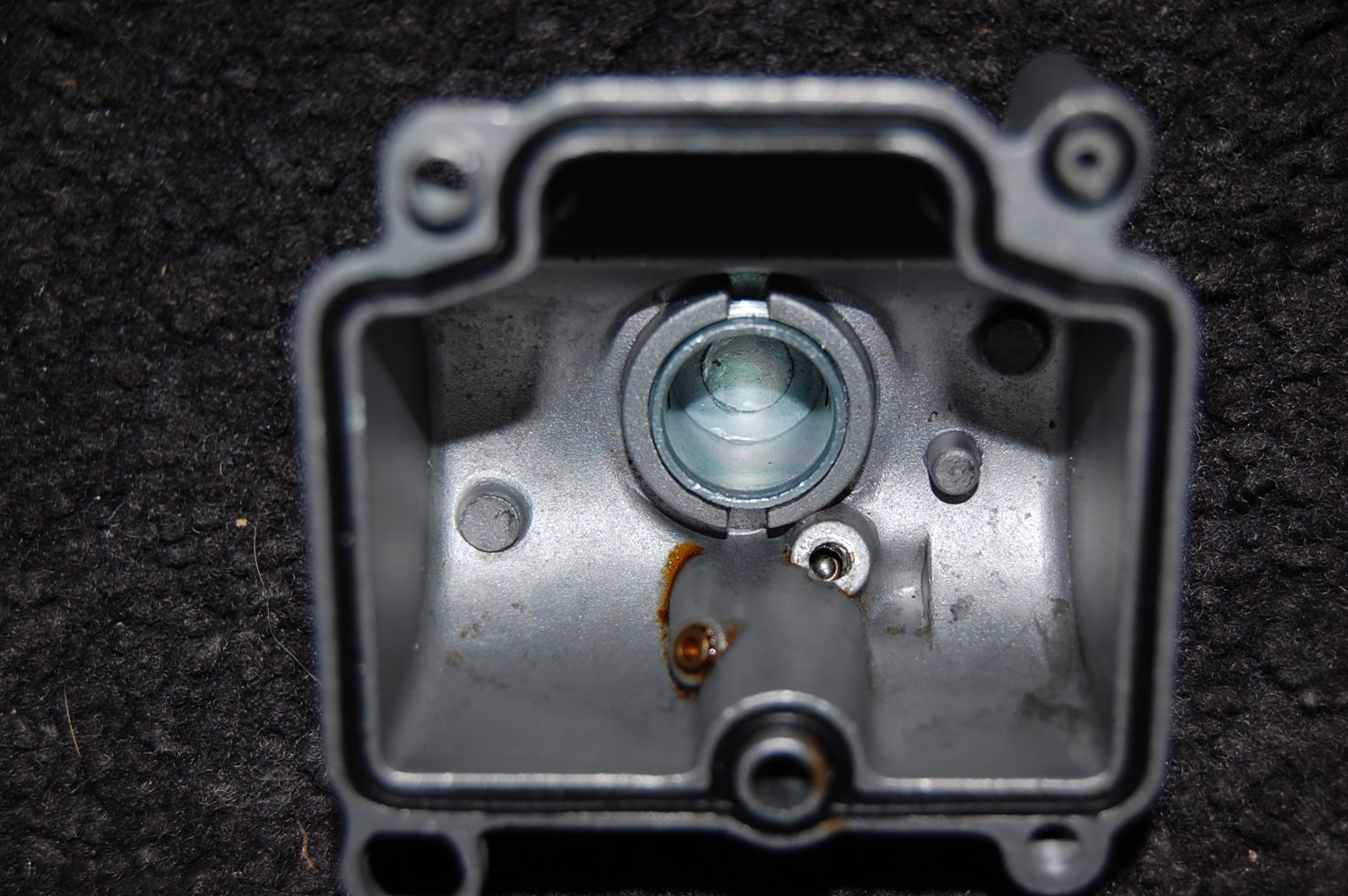

copemech Posted October 8, 2009 Report Share Posted October 8, 2009 Neo said: Hi Cope,I did run the Boyseen reeds with the Keihin 28 too....just for a few days....it was a bit smoother but not really that big a deal (to me). The effect the OKO26 has had is far more than the Boyseen Reeds. I'm running stock timing and everything else. Your OKO24 mods sound interesting.....but while your at it can you lower external drag coefficient of the carb!!!......I like my Trials bikes to cut the air as smoothly as possible Let us know how you go. Best of balance. Neo Ok, get ready! For starters, I have reduced the frontal area to reduce the drag coefficient(CD) and rounded it a bit in an effort to porvide a more laminar airflow! Steel ball of proper size pounded into place to seal off the potential p***ing unit and other hangy down parts that are much offensive in the installation, and rub the motor case and such. Removal of the prick tube that runs up into the bowl and makes bowl instalation a pain unless you happen to be a rubik's cube guru! Screw that thing! Fooking thing is starting to look like a regular carb now, with the exception ov the totally useless fin off the tail of a '57 Chevy hanging off the back of the bowl! This may yet go! That thing and the whole little p*** jet in the inlet side are just about as useless as a dog with two dangles to me! Although I may re-use that stub with the hose on it to provide the added bowl vent tube. Looks "more" better than that straight brass pipe I extracted from the bowl! Need to do some precision drilling and get my measures straight for a good press fit, which means I need to get my number drill index from the airport this weekend, as it must be a near perfect fit. That hose will go next! All said, seems I am working from bottom -up! Quote Link to comment Share on other sites More sharing options...
