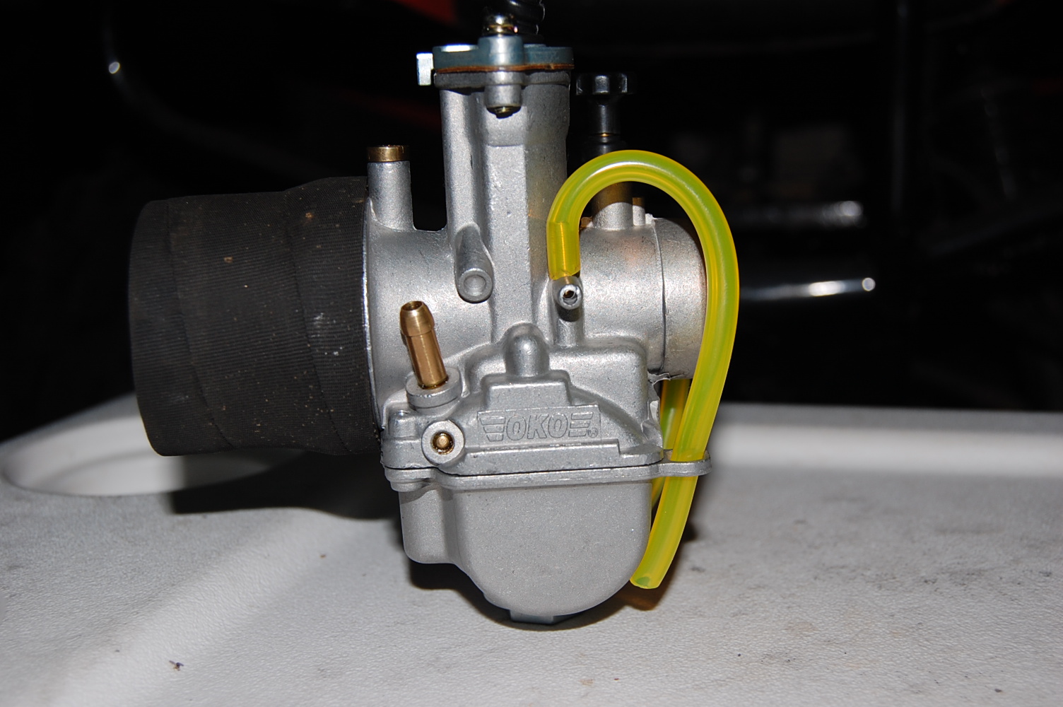

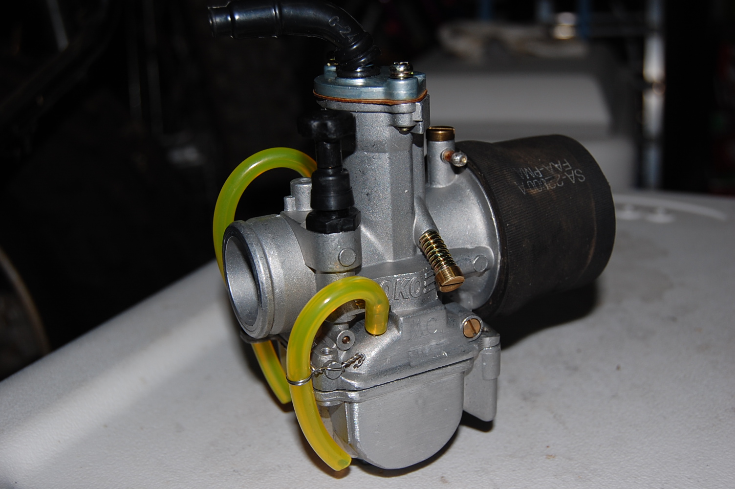

copemech Posted October 11, 2009 Report Share Posted October 11, 2009 I think the dual-vent, non-overflow, short-tube, non-exhaust interfereing, non-secondary jet, non sized thing is about ready for testing. The old intake rubber off the '05 still fits soo tight, it does not require a clamp! Quote Link to comment Share on other sites More sharing options...
tony27 Posted October 12, 2009 Report Share Posted October 12, 2009 Thats some major surgery you've performed there Cope, is the hose on the choke size put there by you as a vent? Ever thought about seeing what that extra powerjet on top at the airbox actually does for a trials engine Quote Link to comment Share on other sites More sharing options...
neo Posted October 12, 2009 Author Report Share Posted October 12, 2009 That awesome stuff Cope Bur can you patronize me a bit this time .......Can you also test your Carb with that second vent, you've drilled out, blocked off.....As crazy as it sounds I seriously believe you won't need it there. And can you give us the details of how you drilled out the top vent and fitted that vertical tube? And also how you removed the bowl overflow tube? Best of luck with the testing. Neo Quote Link to comment Share on other sites More sharing options...
copemech Posted October 13, 2009 Report Share Posted October 13, 2009 Thats some major surgery you've performed there Cope, is the hose on the choke size put there by you as a vent?Ever thought about seeing what that extra powerjet on top at the airbox actually does for a trials engine Yep, that is the tube nipple as removed from the power jet, installed as the secondary bowl vent! I have little need to ride a 2.9 at WOT just to find out what that little thing is good for! The top nipple for it was a bit mis set, and the top screw was holding the nip in as much as anything, so I just soldered it up stuck it back in, and let the top screw hold it! Quote Link to comment Share on other sites More sharing options...
copemech Posted October 13, 2009 Report Share Posted October 13, 2009 (edited) That awesome stuff Cope Bur can you patronize me a bit this time .......Can you also test your Carb with that second vent, you've drilled out, blocked off.....As crazy as it sounds I seriously believe you won't need it there. And can you give us the details of how you drilled out the top vent and fitted that vertical tube? And also how you removed the bowl overflow tube? Best of luck with the testing. Neo Oh, I agree totally, it is not neccessary, just simple redundancy mostly ! And as the right side lateral vent is not in a preferred or accessable position in relation to the muff becomes an almost neccessary evil! Drilling of the left vent on the Kiehin is easily done, which then becomes primary and easily accessable, but not on the Oko! A lot of this comes from my experience of running in some REAL ****ty and muddy conditions at times, add my lasiness of not wanting to have to clean things after every ride. I just want to blast it off and go on, so I require **** deflectors! Seems the overflow tube sticking up into the bowl is indeed a secondary vent, but only if the tube is run down and allowed to p***. Running up and over as in many installs only traps fuel in it, negating any benifit. I just simply took pliars and twisted to yank it out the bowl, then plugged with 1/8 ball. And as things turned out, the lower half of it was reused in the verticle tube on the right, which extends through the hole in the lateral vent shutting it off. I almost cut it off completely, yet it stands protruding uselessly. I trimmed some of the other useless bits off, allowing use of the right front hose loop on the bowl. And in the left rear of the bowl, the actual power jet passage was pinned in the bowl section with a bit of steel pin to shut the passage. On the upper part(body) the steel ball was a bit loose, so I glued one in an apperance item only, passage blocked! Edited October 13, 2009 by copemech Quote Link to comment Share on other sites More sharing options...
