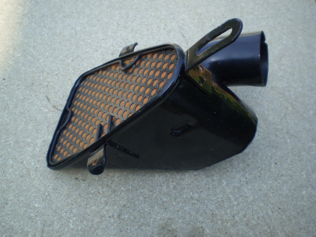

sunny Posted November 13, 2009 Report Share Posted November 13, 2009 This is the air filter from my M80. I was able to cut my own filter from bulk UNI filter mat which I got at my local motorcycle shop for like $20 can. I could easily make a lifetime supply of filters from the one chunk. I only had one sheet of perforated steel with the spring. The old filter had totally broken down. Quote Link to comment Share on other sites More sharing options...
