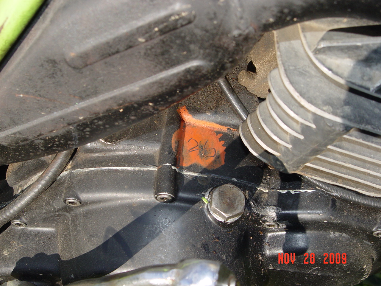

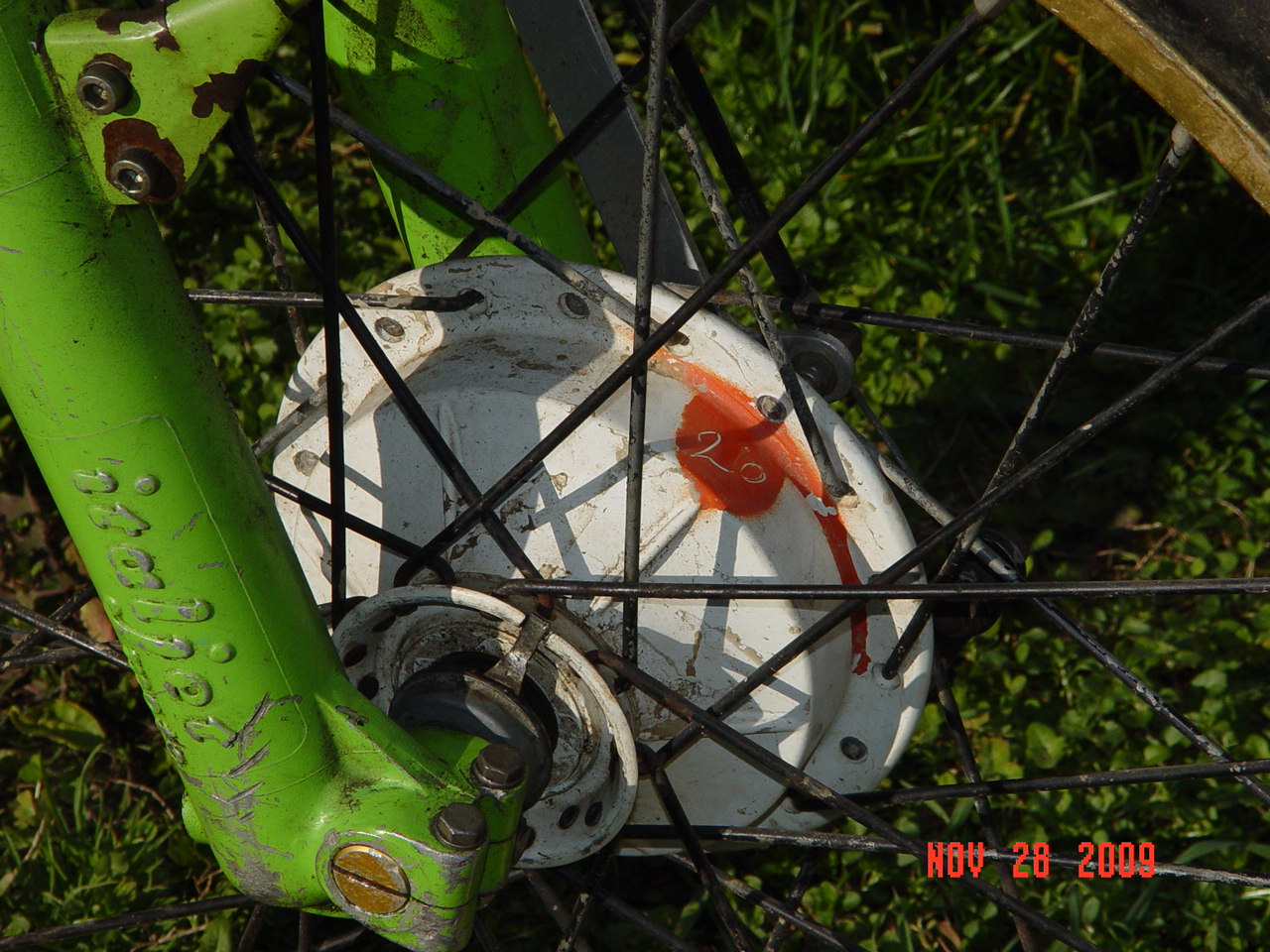

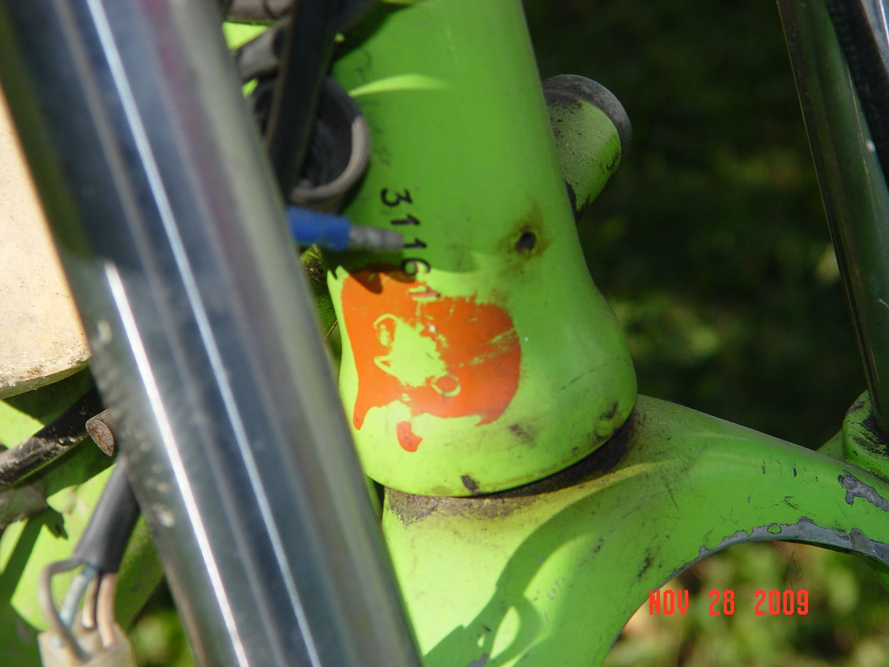

cfraser Posted January 16, 2010 Author Report Share Posted January 16, 2010 Just a quick update on the Italjet restoration. The bike is completely disassembled and the good news, nothing is missing, broken, or worn out. I have contacted Steve Goode regarding cables. I'm sand blasting the frame today as well as glass beading the softer parts. I'm including a few pictures that were taken prior to disassembly showing the paint dabs. I have also sanded the tank and performed some plastic welding. I used a heat gun to renew the plastic tank after the sanding and the tank looks as good as new. I hope to start posting pictures of the restoration as I progress with the project. All the best, Carl Quote Link to comment Share on other sites More sharing options...
