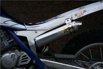

Just because I had one lying about that I used for my RTL, I thought I wonder if??
In the US you need a spark arrestor for most events anyway and one of the mods for the bike is taking out the restrictors, using the bottom connection of the stock exhaust that fits right into the universal FMF spark arrestor you can kill two birds with one stone.
The top mounting bracket just slides into place so no welding or fabricating needed.
