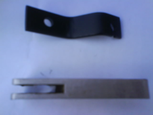

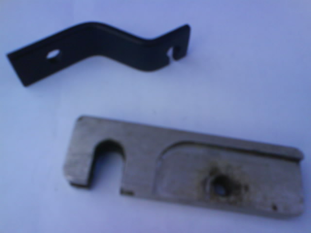

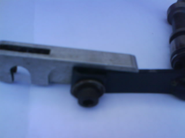

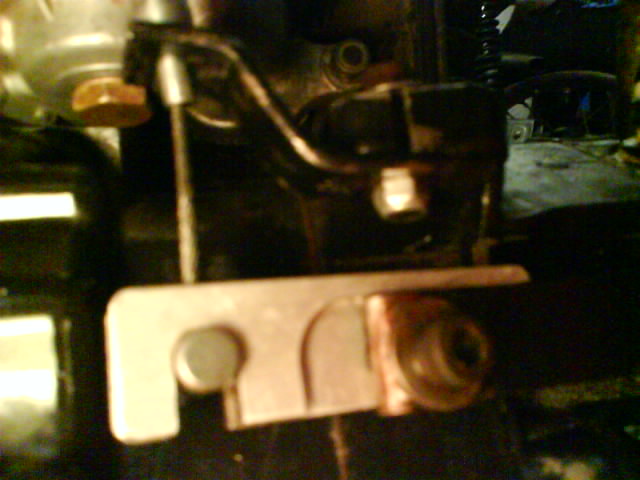

Hi
I'm running silkolene light gear oil , which i change every 5 trials ,i have a spare engine clutch arm which can be chopped and extended if anybody as more info ,i'm pretty sure this is the way to go for a
lighter clutch action ..... :biggrinsanta::thumbup:
Link to comment
My 300 Pro had an extended arm & it made a huge difference - with a short ' 2 finger' clutch lever you could feather the clutch with 1 finger in a section. I got it with the mod.
I no longer have the bike (stupid mistake - selling it!) so I cant measure it for you, but there was a clearance limit to what you could add. It took a bit of time to adjust as well because of the longer throw on the lever, otherwise it would slip. Also found a good well lubricated cable was critical.
