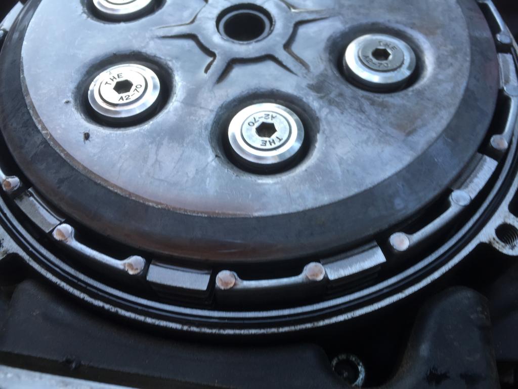

dan williams Posted June 12, 2015 Author Report Share Posted June 12, 2015 Basically it applies to all bikes that have a poor finish on the tabs. I did it to my 2013 and my buddy's 2014. It's worth pulling the clutch pack and having a look at the tabs and the space between the friction pads. 1 Quote Link to comment Share on other sites More sharing options...

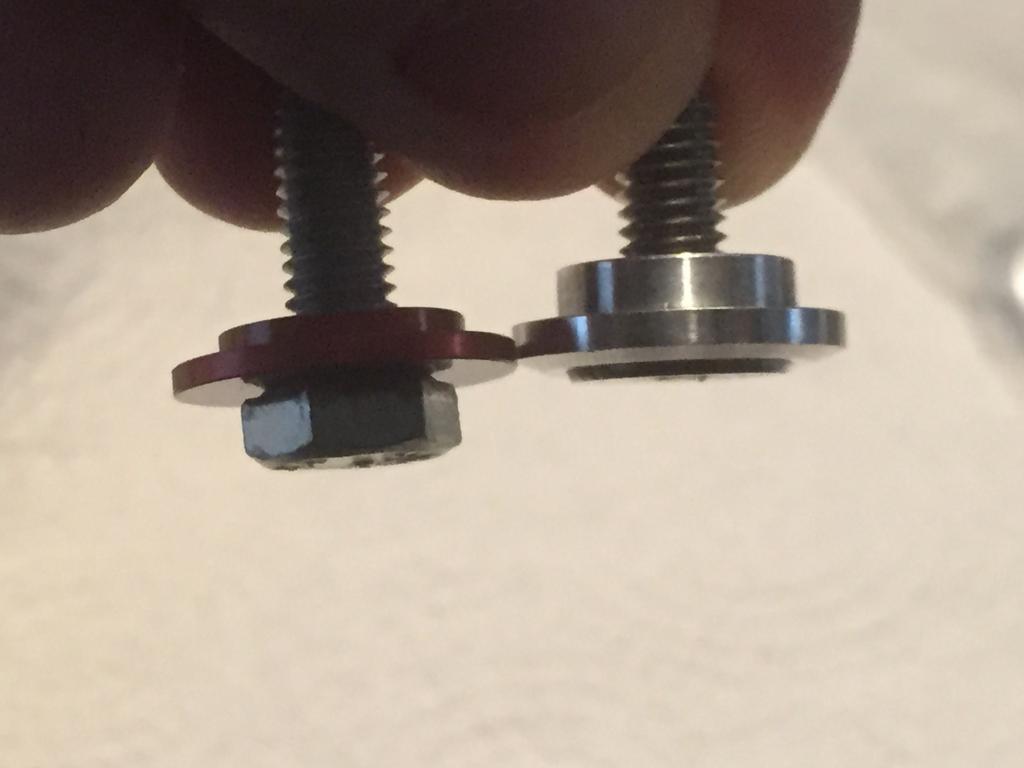

dan williams Posted June 20, 2015 Author Report Share Posted June 20, 2015 IKB replica washers installed. Now to just ride the beast and see what it's like. 1 Quote Link to comment Share on other sites More sharing options...

al_orange Posted June 29, 2015 Report Share Posted June 29, 2015 Hi, So what is the verdict on the Surflex friction plates? I've just spent 3 hours cleaning my stock plates up only to find that one of the friction plates has snapped!! It's the first time I've taken the plates out so I have no idea how long it's been like that. I'm tempted to finish the clean up and put them back in...It's a 2001 and they may well be the original plates. Pretty much all of the friction plates are filled with glue on both sides between the pads.. terrible production. If the Surflex plates address the glue and tab issues then I'll splash for a set. Quote Link to comment Share on other sites More sharing options...
totty79 Posted June 29, 2015 Report Share Posted June 29, 2015 Surflex plates still have the glue between the friction material. The tabs on the ones I bought were better than stock so I just knocked off the odd high spot. I fitted new steels at the same time. Applying the fix to my stock clutch made little difference, there was probably something else wrong, after the surflex replacements the clutch works properly. Quote Link to comment Share on other sites More sharing options...

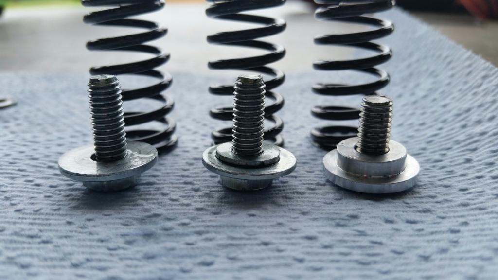

19delta Posted June 30, 2015 Report Share Posted June 30, 2015 Thanks a bunch to Dan for sending me a set of the super trick spacers! I installed them last week, and rode for 5-6 hours. Clutch is like a dream! VERY light clutch lever pull. (I had previously removed glue and polished the tabs) I had previously installed washers. This is dramatically better. We'll see how these are long term. Right now, the clutch grabs like it should in all gears EXCEPT 6th. If I'm in high, and floor it, it WILL slip. I just simply won't do that. If I ease into it and roll it up, it's fine. BTW, mine is a 2011 Beta Evo 250. I highly recommend these. Bike feels 15lbs lighter because it's so easy to pull the clutch! Reminds me of my son's beta 80! Thanks again Dan! Picture is of stock, washer, new super-fly-trick-space-age-spacer. Quote Link to comment Share on other sites More sharing options...
al_orange Posted July 1, 2015 Report Share Posted July 1, 2015 (edited) Another happy customer! Damn was that a mind-numbing task! Tbh, I only did it out of interest but I'm quite happy with the results. The clutch definitely feels less grabby - I'm terrible for snatching and jerking around slow corners so maybe that'll help a little There's no clutch drag when the bike is in gear and the engine is running - still drags when the engine is off but the bike wasn't fully warm The big differences, although not critical but sooo nice, is that I can now snick it into neutral as easy as pie. Gear changes feel a lot nicer too. Probably won't make a world of difference at my very novice level but I can already tell that the bike will be nicer to live with. Just being able to roll it back without having to find neutral and being able to select neutral and rest without stopping the engine will be great! Thanks Dan. Edit - haven't removed the 2 springs or put washers in to adjust the preload but it already feels lighter because it's much smoother to operate. Edited July 1, 2015 by al_orange Quote Link to comment Share on other sites More sharing options...
dan williams Posted July 1, 2015 Author Report Share Posted July 1, 2015 Great. It makes a load of difference at novice level. You can now feather the clutch and work throttle and clutch against back brake for really fine control. That's where the lower preload on the springs pays off in less fatigue at the end of the day. It may slip a little in sixth but nobody is scoring you when you're in sixth. Quote Link to comment Share on other sites More sharing options...
