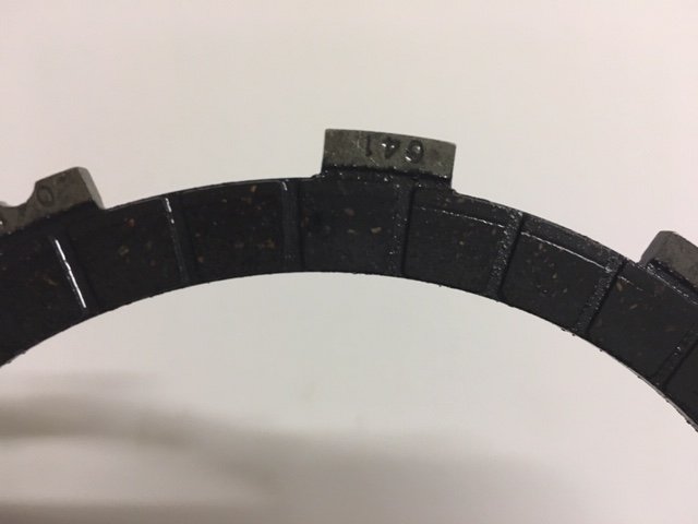

Beta rev'3 Posted February 16, 2019 Report Share Posted February 16, 2019 I've just done a service a first service on my '19 250 evo so decided to take a look at the clutch...to be fair the plates are very clean. Did anyone ever find some lighter springs with regards to lightening the pull over here in the uk ? Quote Link to comment Share on other sites More sharing options...
dan williams Posted February 16, 2019 Author Report Share Posted February 16, 2019 (edited) Not sure I’d call that clean. Also that’s one of the 3mm thick plates. I take those out and replace with the 2.7mm thick plates on the 2T. What’s that groove in the pads? I’m out of the 3mm spacers I had made so I can’t send any to you. Edited February 16, 2019 by dan williams Quote Link to comment Share on other sites More sharing options...
Beta rev'3 Posted February 16, 2019 Report Share Posted February 16, 2019 Hi Dan no they weren't overly clean on closer inspection, not sure about the groove to be honest I didn't notice it till you pointed it out..I'll put them back in now I've cleaned them up and see what they're like. Quote Link to comment Share on other sites More sharing options...

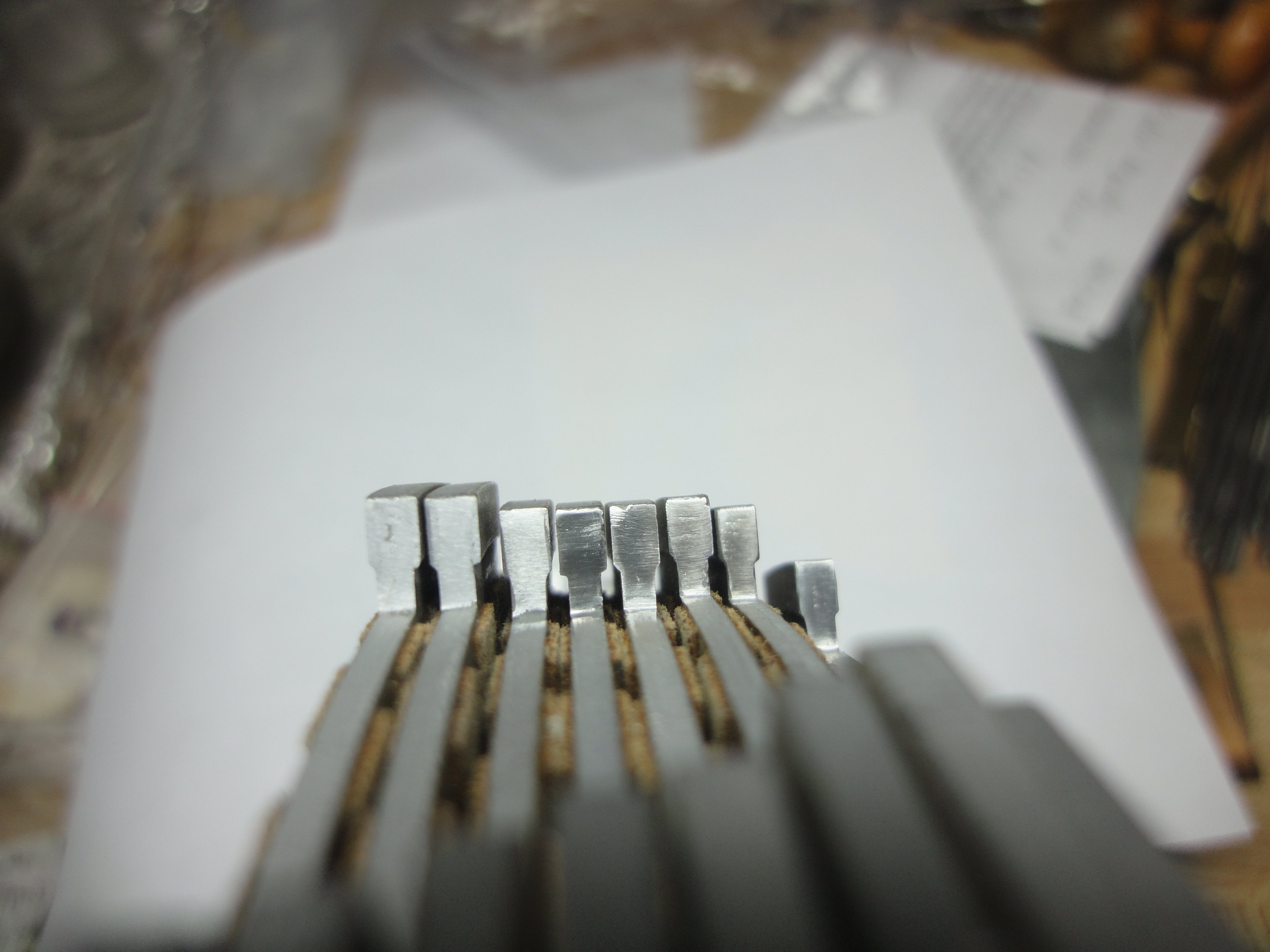

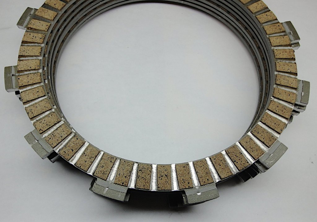

Eric Brackenbury Posted March 29, 2019 Report Share Posted March 29, 2019 Hi Dan and the rest of the folks reading this thread. I have finished doing the clutch on my 300 4T factory bike and although the spring pull is fairly firm, the whole movement of the clutch lever is Soooo smooth now. I also did my 390 RR 4T and the improvements to that are amazing. Now I will tell you I have been hand making jewellery for nearly 60 years, what's that got to do with it you ASK ! Well a number of advantages, I have very trained eyes for detail and tools most folks don't even know exist. I removed the excess glue from between the fibre pads with a flat hand carving tool, somewhat like a wide hand engraving cutter. There is no glue as I got it down to the bare metal including the grooves in the tabs. Next I took a cut 4 hand file and cleaned the leading and trailing edges of the tabs with just enough stroke to do the job, then one light stroke to remove the sharp edges. Next I polished them with a fine emery paper (not wet and dry) , All the time I was using my +3 headset and my working glasses. Now you will understand better Why I mentioned what I do. The point is, it pays to get in there visually so you see and understand what exactly you are achieving. I hope my information will help someone to do the best job they can. Thanks so much for your help and .pdf on this subject Dan Quote Link to comment Share on other sites More sharing options...
