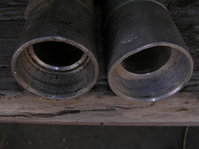

Bultaco Betor forks were not the only 1970s forks to have vented caps.
Yes non-vented caps can be used to tune the overall spring rate but beware because Bultaco Betors only have friction to retain the the fork seals so if the pressure goes too high you may cause a seal to pop out. I have been running a Sherpa T with non-vented caps and haven't had a problem yet, but that is no guarantee of anything

The early Sherpas have non vented caps and cause no problems, the later vented caps can actually leak oil after a hard days riding resulting in many riders I know actually sealing up the vent, with no adverse effect. The action of the forks is the same. All my sherpas have a circlip holding the seal in place, I have never heard of anyone blowing a seal with either setup and Ive had sherpas since 1970
