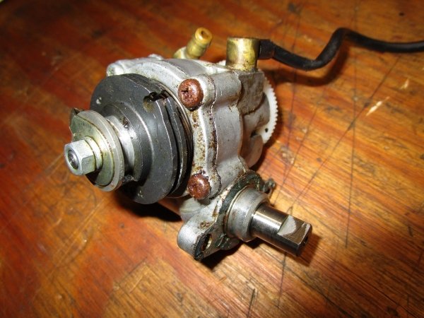

YamaDude Posted June 23, 2019 Report Share Posted June 23, 2019 Hello Gents, I have a '74 TY 250 in good condition. I am in the process of going pre-mix with it, and therefore removing the autolube pump. I pulled the pump today, and the pump drive shaft came out with it (see attached picture). So, it seems that all I need to do now is attach a block-off plate (I've studied this procedure) on the case, am I correct? Or do I necessarily need to pull off the engine case and remove other bits? Thanks in advance ! Quote Link to comment Share on other sites More sharing options...
