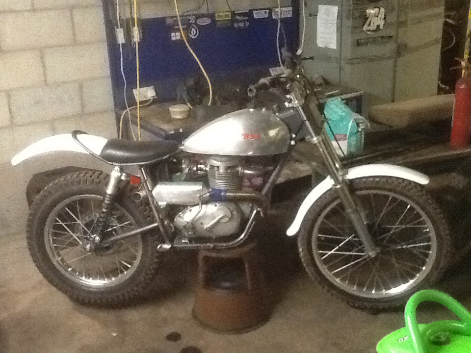

andy m Posted December 31, 2014 Report Share Posted December 31, 2014 I have a replica frame, engine being sorted . May get more made if any genuine interest. https://fbcdn-sphotos-h-a.akamaihd.net/hphotos-ak-xfa1/v/t1.0-9/205662_420612838019413_1687052045_n.jpg?oh=c4392702f5e88de6565fdddbbc3c266c&oe=54F94522&__gda__=1429517483_910d6bc690461b9967d41c7c8c86b591 Quote Link to comment Share on other sites More sharing options...

chell146 Posted February 12, 2015 Report Share Posted February 12, 2015 Here is my MIKE Mills framed B40 1 Quote Link to comment Share on other sites More sharing options...

chell146 Posted February 14, 2015 Report Share Posted February 14, 2015 Hi Andy just a thought if you are using a C15-B25 no problem as long as it's not been stroked,B40 and long stroke 250's are too tall as standard so might be an idea to check this out.your frame may have been constructed with this in mind however cheers Simon. Quote Link to comment Share on other sites More sharing options...
bobb Posted February 15, 2015 Report Share Posted February 15, 2015 very nice bike ! why is the front pipe so long ? i have seen that on some bsa's others have really short front pipes Quote Link to comment Share on other sites More sharing options...
andy m Posted February 15, 2015 Report Share Posted February 15, 2015 Hi Andy just a thought if you are using a C15-B25 no problem as long as it's not been stroked,B40 and long stroke 250's are too tall as standard so might be an idea to check this out.your frame may have been constructed with this in mind however cheers Simon. Simon, I am using a C15 distributor engine, just sorting it at present. Quote Link to comment Share on other sites More sharing options...
