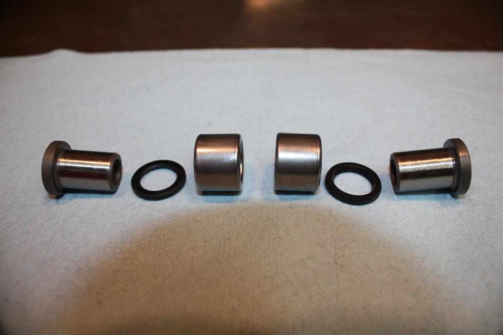

You'll probably need to drive out the bolt with a long, thin drift or piece of rod. Count on replacing all the parts as you'll most likely find rusted pieces. The inner bushings go in from either side (they look like top hats, and it's a good idea to look at a parts manual to get an idea of how the parts are assembled) and use a thin drift with the end cut square so you have a sharp edge to catch the bushing in the center of the bore and drive it out.

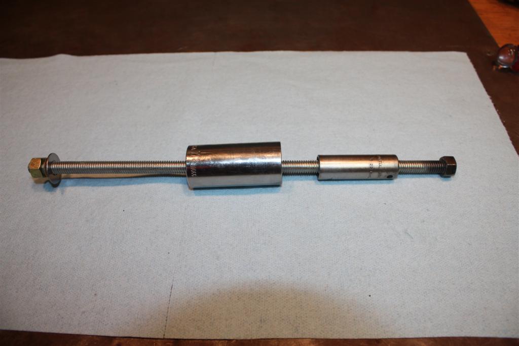

Unless you plan on taking the swingarm off to press out the bearings (not a fun job) you can make a simple bearing removal tool with a short length of threaded rod and two long sockets. The smaller socket should be slightly smaller diameter than the bearing shell and the larger socket should have an inside diameter large enough to contain the bearing shell when it is pressed out. Thread the rod through the bore, tighten up the nuts and the small socket will press the bearing shells out the side and into the larger socket. Lots of penetrating oil helps. You can also use the tool to install the new bearings after you've carefully cleaned out the bore.
