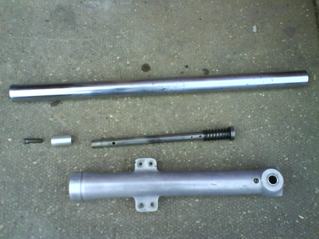

hewson Posted March 25, 2010 Report Share Posted March 25, 2010 (edited) Hi Guy's Just on with changing the fork seals on my Sprite , so while they are in bits are there any mods that can be done to improve the forks , also anybody know of other springs that will stiffen the front end up .. Any info grateful Edited March 25, 2010 by hewson Quote Link to comment Share on other sites More sharing options...
max1956bikes Posted March 25, 2010 Report Share Posted March 25, 2010 you could put few washers between top of spring and top nut Quote Link to comment Share on other sites More sharing options...
hewson Posted March 28, 2010 Author Report Share Posted March 28, 2010 Hi again New seals fitted , anybody know how much fork oil per leg .....Cheers Quote Link to comment Share on other sites More sharing options...
farmer58za Posted March 28, 2010 Report Share Posted March 28, 2010 Hi again New seals fitted , anybody know how much fork oil per leg .....Cheers Try 200cc per leg as a starting point. That's about what you use in Betors and Ceriainis if the same vintage. Regards David Quote Link to comment Share on other sites More sharing options...
