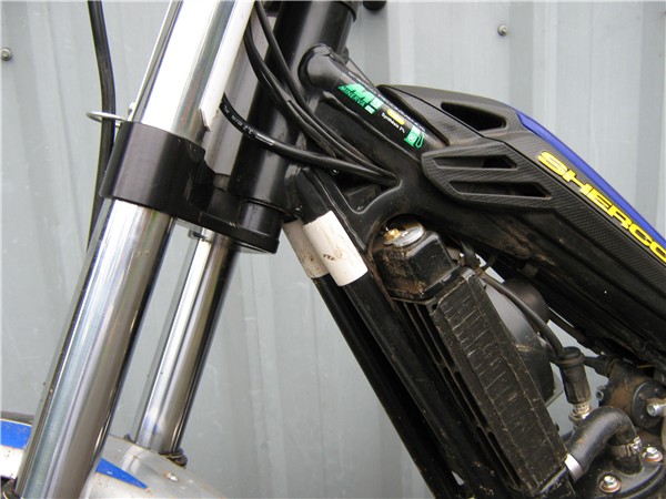

ishy Posted May 11, 2010 Report Share Posted May 11, 2010 Simple cheap fix, the damage is caused by the lower tripple clamp hitting the frame, the mod stops this. All that is needed is a bit of plastic pipe, I used half inch water pipe, about 1.1/2 " long then cut down the length to snap on the frame tube. This mod was posted on the RYP site a few weeks ago, I think the factory will probably beef it up for the 2011 model. Quote Link to comment Share on other sites More sharing options...
wayne thais Posted May 11, 2010 Report Share Posted May 11, 2010 (edited) I would not cut the frame. The solution that Ishy shows should work. Gas Gas pro bikes have a piece of rubber that is used to prevent denting the frame. Edited May 11, 2010 by Wayne Thais Quote Link to comment Share on other sites More sharing options...
