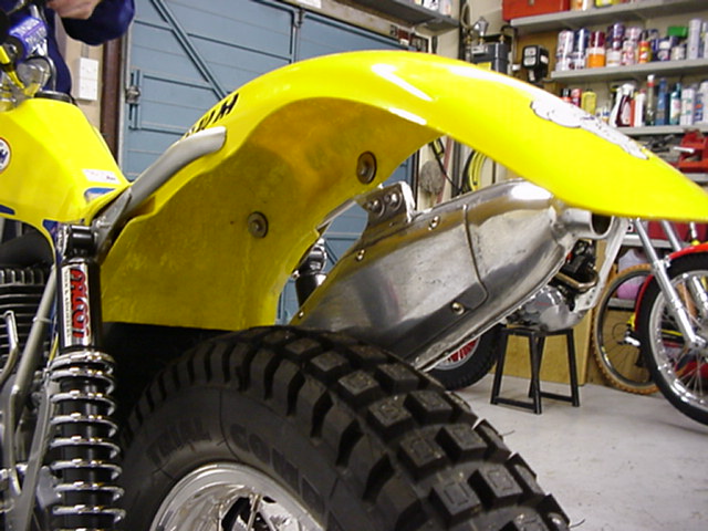

t-shock 250 Posted January 19, 2005 Report Share Posted January 19, 2005 Why go to all the hassle of cutting your pipe open round the outside weld and then having to weld the thing back up at great expense, only to repeat the process next time you need to re-pack? You can get a door welded in the back and fixed with some screws so you can repack as many times as you like for no cost! Like this........ Quote Link to comment Share on other sites More sharing options...
alan bechard Posted January 19, 2005 Report Share Posted January 19, 2005 Cool,,, Did you weld a shelf in there to bolt it too? Do you seal it with RTV or such and does it not blow out? Looks like a good deal. Quote Link to comment Share on other sites More sharing options...
t-shock 250 Posted January 19, 2005 Report Share Posted January 19, 2005 Yeah, exactly! a shelf just wide enough to screw into (or attach clinch nuts in this case) and just use some silicone to help seal it, never leaked yet! flush fitting too so your tyre doesn't rub. Quote Link to comment Share on other sites More sharing options...
