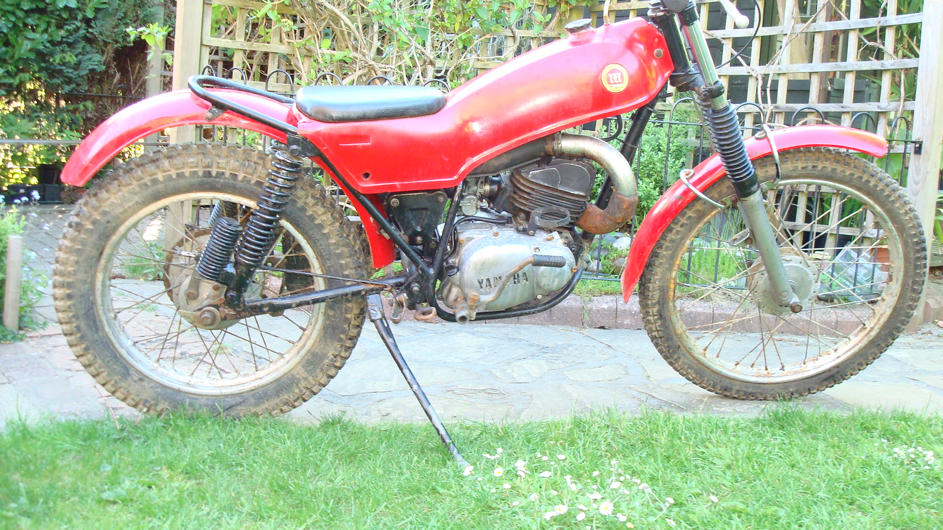

bigmike1961 Posted May 22, 2010 Report Share Posted May 22, 2010 (edited) Just picked up this wreck! I bid, didn't expect to win but here it is! Question is what is it? There's a Yamaha engine stuffed in at the moment. any idea of the size? Any way here's some photos. Edited May 22, 2010 by BigMike1961 Quote Link to comment Share on other sites More sharing options...

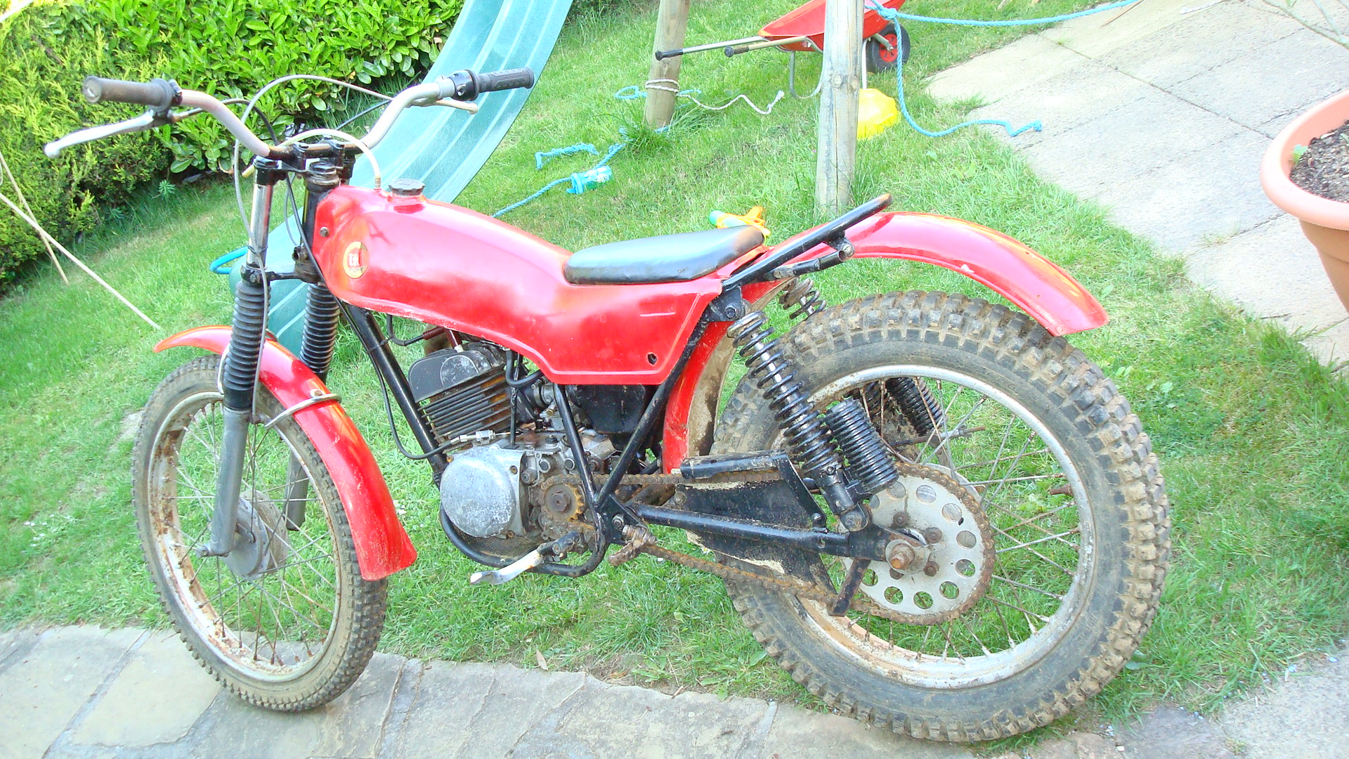

bigmike1961 Posted May 22, 2010 Author Report Share Posted May 22, 2010 (edited) Heres another photo! It's got chrome (well they used to be) rims, 17" rear and a 21" front and rather spindly forks 30mm I think. Oh and the most shot front wheel bearings I've ever seem - 3/4" lateral play at the rim The motor has got to go - flea bay so an ID of the engine would be very helpful. Edited May 22, 2010 by BigMike1961 Quote Link to comment Share on other sites More sharing options...

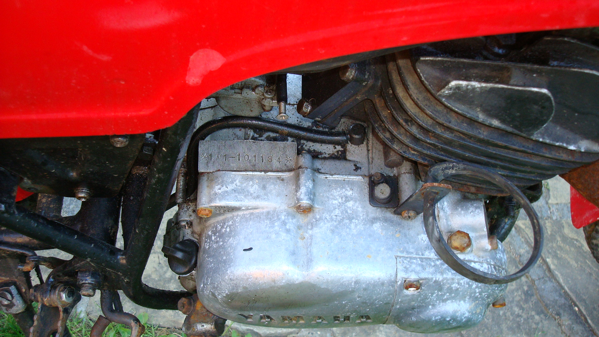

bigmike1961 Posted May 22, 2010 Author Report Share Posted May 22, 2010 Here's the engine number:- Quote Link to comment Share on other sites More sharing options...
scorpa250 Posted May 22, 2010 Report Share Posted May 22, 2010 hi what you have there ia a montesa 123 rolling chassis (i think) witha yamaha dt175 engine (or dt125) .Regards Paul Quote Link to comment Share on other sites More sharing options...
andy m Posted May 22, 2010 Report Share Posted May 22, 2010 You should be able to see the engine size stamped on the bottom of the barrel , it is a t shock DT motor 100 - 175 ?? Could be a road RS engine maybe?? Quote Link to comment Share on other sites More sharing options...

feetupfun Posted May 23, 2010 Report Share Posted May 23, 2010 I just noticed the amazing bit of plumbing where the exhaust pipe leaves the barrel. I've never seen a header pipe squeezed into such a tiny gap Quote Link to comment Share on other sites More sharing options...
axulsuv Posted May 23, 2010 Report Share Posted May 23, 2010 It could be quite interesting if you stuffed a ty175 motor in place of the lump that is there now . The hard part (the exhaust ...) looks to already be done ... Just a thought ! Glenn Quote Link to comment Share on other sites More sharing options...

bigmike1961 Posted May 28, 2010 Author Report Share Posted May 28, 2010 (edited) HI SCRAB http://www.google.com/imgres?imgurl=http:/...%26tbs%3Disch:1 cheers Hmm that looks interesting, My french isn't too good but it looks like they've got a 125 honda into the Montesa 123 frame. There is hope yet. The exhaust is amazing the bolt passes through the exhaust pipe to get the fixing into the barrel. It's a 97cc lump, I put me specs on and found some rather small castings giving the cc's.. I think I'd have to go to 21" & 18" rims, there's a 20 inch on the front not a 21" as I first thought. Is it a problem changing rim sizes - obviously the spokes would need changing but the current ones are rusty as are the rims. I would have to lower the engine cradle to get the required height for the engine but then the sprocket might be too low to clear the swinging arm pivot I'll have to wave the tape measure around very carefully. No-one has remarked on the rear brake pedal?!!! Take a look in the second pic! What do you think? Mike Edited May 28, 2010 by BigMike1961 Quote Link to comment Share on other sites More sharing options...
