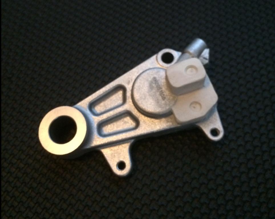

shedracer Posted February 17, 2015 Report Share Posted February 17, 2015 (edited) Franck the attention to detail is very good, love the factory look fuel gauge on the shelter, with your alloy tank. Very well done Franck. I see you have fitted a differant rear brake master cylinder, is that due to the lower foot peg mounts, they do look very low, or is it because it works better with your trick billet machined rear caliper? What make is that rear silencer, is it a Mitani? Edited February 18, 2015 by shedracer Quote Link to comment Share on other sites More sharing options...
panerai Posted February 18, 2015 Author Report Share Posted February 18, 2015 My rear master cylinder is a Brembo, its bore size is different from std, the fitting is in the same spirit from the 270... The rear std brake is a ****, its don't brake good, mine is OK Other transformation are already started... Kcnarf. Ps: to you to show your works, show me your motorcycle 1 Quote Link to comment Share on other sites More sharing options...

panerai Posted November 29, 2015 Author Report Share Posted November 29, 2015 Très belle bravo !!! it will take one day we meet... 315' full front fork, wheels' hub is talon ? how did you do to adjust the rear brake caliper ? pictures ? En Français dans le texte : encore bravo Franck. Quote Link to comment Share on other sites More sharing options...
cornishtwinspring Posted November 29, 2015 Report Share Posted November 29, 2015 That looks awesome,its a pleasure to ride such machines. Congrats on a beautiful bike. Quote Link to comment Share on other sites More sharing options...
jj65 Posted November 29, 2015 Report Share Posted November 29, 2015 Très belle bravo !!! it will take one day we meet... 315' full front fork, wheels' hub is talon ? how did you do to adjust the rear brake caliper ? pictures ? En Français dans le texte : encore bravo Franck. Thanks. Made a prototype out of clay and then got a small bracket made (not how I wanted it ) to use a modified 4rt rear caliper, so it adjusts like the original. Forks and triple clamps are 4rt, hubs are talon. Quote Link to comment Share on other sites More sharing options...
