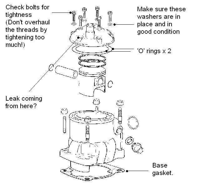

gjbiker Posted August 21, 2010 Report Share Posted August 21, 2010 (edited) Hi Gordee, not really such a thing as a workshop manual but there is a whole heap of useful info HERE including a parts catalogue for your model. I'm guessing you're not too familiar with working on a 2 stroke engine? The only oil that would escape from where you are describing would be the oil already mixed with the petrol? Possible and likely cause being the inner 'o' ring between the head and the barrel. Have you experienced any overflow from your radiator? This is also a side effect caused by piston pressure passing by the 'o' ring. Have you tried 'nipping' up the head bolts or even checking to see if the 'oiled' up ones are slack? Have you noticed any coolant loss? Whatever the symptoms it sounds like you need to replace the TWO 'o' rings between the head and the barrel. Quite a simple task but just check everything first and let us know how you get on? (You shouldn't need a new base gasket unless you remove the barrel) Cheers, GJ Edited August 21, 2010 by gjbiker Quote Link to comment Share on other sites More sharing options...
gordeee Posted August 21, 2010 Author Report Share Posted August 21, 2010 GJ Thanks for taking the time to reply, the drawing and info is much appreciated. My description of where the leak was coming from was incorrect, it's actually from the Barrel fixing nut that has the triangular mounting plate fitted to it. I did try nipping them up to 20 lb/ft, no joy ,just a small weep from the one nut as before. The engine was rebuilt professionally last year and otherwise runs very well. Yeah, you're right, I'm not too familiar with working on a 2 stroke engines. Mostly old Land Rovers Cheers Gordie Quote Link to comment Share on other sites More sharing options...
