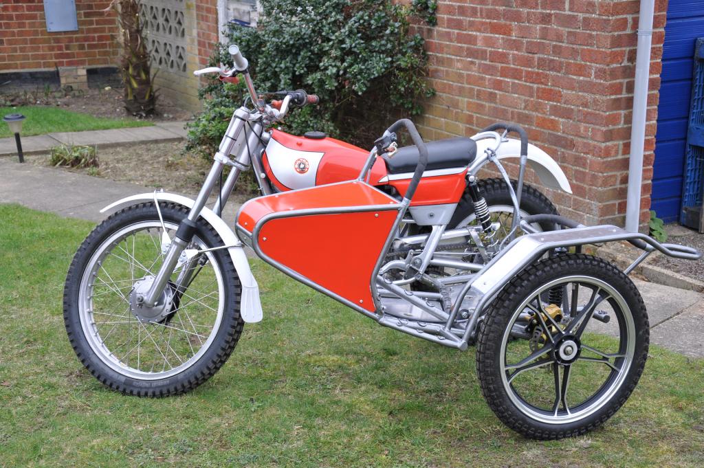

p@ul250 Posted April 11, 2013 Report Share Posted April 11, 2013 Well after a lot of looking about on the internet I finally bit the bullet and started bending some pipe! This is what my fourteen year old son and I came up with. so far it's been a very steep learning curve riding it. But huge fun. So go on give it a go! 1 Quote Link to comment Share on other sites More sharing options...

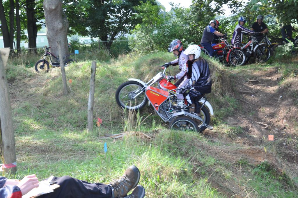

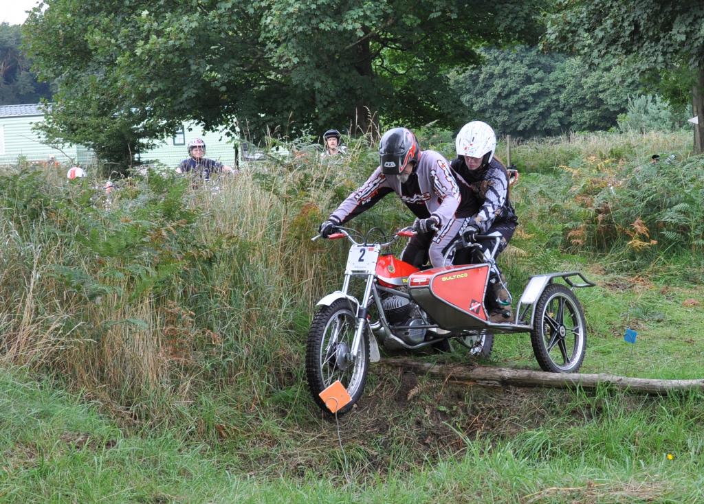

p@ul250 Posted August 26, 2013 Report Share Posted August 26, 2013 Well the Bultaco outfit seems to be working out OK. We have been riding it as much as we can and competed in our first trial yesterday. Managed to make it through all the sections and got a few cleans as well. Quote Link to comment Share on other sites More sharing options...
