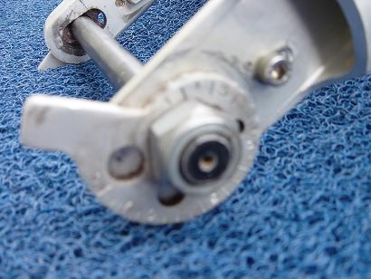

nigel dabster Posted January 29, 2005 Report Share Posted January 29, 2005 here Quote Link to comment Share on other sites More sharing options...

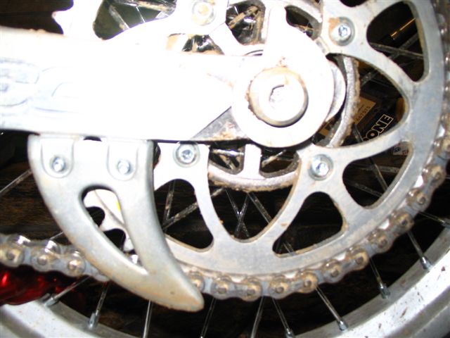

charliechitlins Posted January 29, 2005 Report Share Posted January 29, 2005 Right. Later model Sherco. Just a 'lump' that's part of the swingarm that the snail butts against. Less parts=better. No parts=best. Quote Link to comment Share on other sites More sharing options...

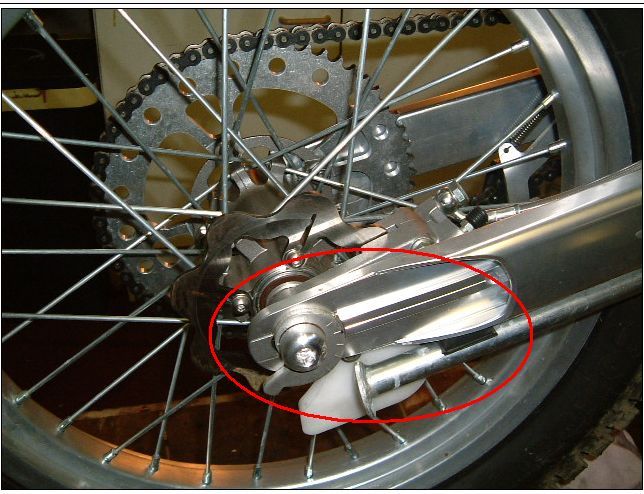

craftypiggy Posted January 30, 2005 Report Share Posted January 30, 2005 (edited) I think Scorpa's chain adjuster set-up is very good, instead of relying on one bolt it uses the full strength of the swingarm.I think another solution would be to weld or have welded something similar onto the swingarm. By the way I am not biassed I ride a Rev-3 Lloyd Edited January 30, 2005 by craftypiggy Quote Link to comment Share on other sites More sharing options...
stuessenhigh Posted January 31, 2005 Author Report Share Posted January 31, 2005 Yeah...thanks Dabster/craftypiggy The Scorpa, Gas Gas, AND Sherco..ALL have a better/similar system. THe Beta one really IS pants. SHame really...ah well,...in the future I will try to get something fabricated like the others..for now, my mate is still gonna re-do the current system. Pictures of his fix soon! Quote Link to comment Share on other sites More sharing options...

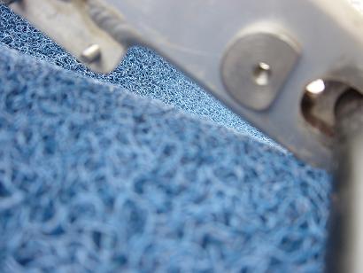

stuessenhigh Posted January 31, 2005 Author Report Share Posted January 31, 2005 OK..here it is!!..the fix to my swingarm problem. My mate put a kind of insert in the whole, with a large back on it..(on the inside of the swingarm) and then the same type..(but longer) hex bolt, to go into the insert. HOPEFULLY the picture/s speak for themselves. Yippee!..I'm on the road again!!..or should it be off the road? Quote Link to comment Share on other sites More sharing options...
stuessenhigh Posted January 31, 2005 Author Report Share Posted January 31, 2005 Obviously..that last photo was from the inside of the swingarm...here's one from the outside. Sorry for the slightly blurry pictures. Quote Link to comment Share on other sites More sharing options...
craftypiggy Posted January 31, 2005 Report Share Posted January 31, 2005 Looks like a good neat fix, Its good that the innerside of the swingarm supports the bolt aswell as the outerside. Let us know how it goes when your riding. Lloyd Quote Link to comment Share on other sites More sharing options...
