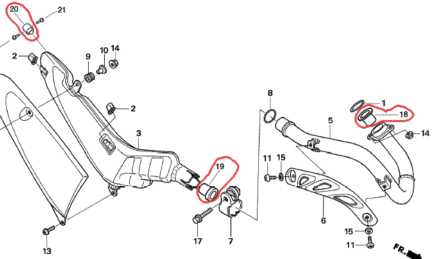

bambam_n_chunx Posted September 10, 2010 Report Share Posted September 10, 2010 I`ve just been told that my 07 repsol still has its exhaust restrictors fitted. Just wondered if its worth my while taking them out and what the benefits will be. The bike seems to go well enough as it is so I`m thinking if its not broke dont try and fix it. Also how many restrictors are there and where, the obvious one is bolted into the back of the silencer and there seems to be a loose pipe behind the exhaust seal at the front of the silencer. Cheers Andy Quote Link to comment Share on other sites More sharing options...
gizza5 Posted September 10, 2010 Report Share Posted September 10, 2010 Just left the rear one in the other 2 are out 1 Quote Link to comment Share on other sites More sharing options...
helmetfire Posted September 10, 2010 Report Share Posted September 10, 2010 How much of a difference does it make in performance, and how much louder is it with the front two removed? Quote Link to comment Share on other sites More sharing options...
gizza5 Posted September 10, 2010 Report Share Posted September 10, 2010 How much of a difference does it make in performance, and how much louder is it with the front two removed? Performance is much improved with the front two out, the reason I put the back one in is that performance wise it was pretty much the same whether it was attatched or not, but it just took the ''Bark'' slightly out of the exhaust note. Of course the noise factor is only relevant to how much you open the throttle I would say a 2-stroke ringing its neck to clear its throat in the hands of some young lad at the start of each section and rock step is a lot louder than my 4RT Quote Link to comment Share on other sites More sharing options...

sectiononecleaner Posted September 10, 2010 Report Share Posted September 10, 2010 Made a big difference when i took mine out. Love the pretty diagram Gizza, you must have some time on ya hands, lol. East yorkshire 2 day roll on Quote Link to comment Share on other sites More sharing options...

esteve Posted August 26, 2013 Report Share Posted August 26, 2013 (edited) Thankyou for this diagram. My manual is in Spanish and I had sort of deduced the "casquillos" 18 and 19 are the restrictors. Another question on the subject of exhausts; the front pipe on my 2005 appears to be a smaller diameter and has a thick weld after the first bend. When I compare it with images of a later pipe the later pipe has no weld and appears to be a larger outer diameter. Is the weld another restriction? Is the 2005 front pipe a smaller OD than the later ones? My 2005 here: And here is a later type: Thankyou Edited August 26, 2013 by esteve Quote Link to comment Share on other sites More sharing options...
