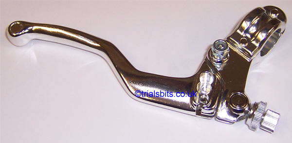

b40rt Posted November 1, 2010 Report Share Posted November 1, 2010 Hi all, got a good second hand clutch centre from MartinM (thanks) have put in 3 soft + 3 medium springs along with a 3 way lever Haven't had a proper chance to try it yet but is one finger light, and doesn't seem to slip until 5/6th gear if you drop the clutch. I have removed any ridges on the clutch basket, but read on here somewhere about setting up the adjustment screw on the thrust bearing, but now cant find the info, so would appreciate pointing in the right direction. Thanks Ross Quote Link to comment Share on other sites More sharing options...
