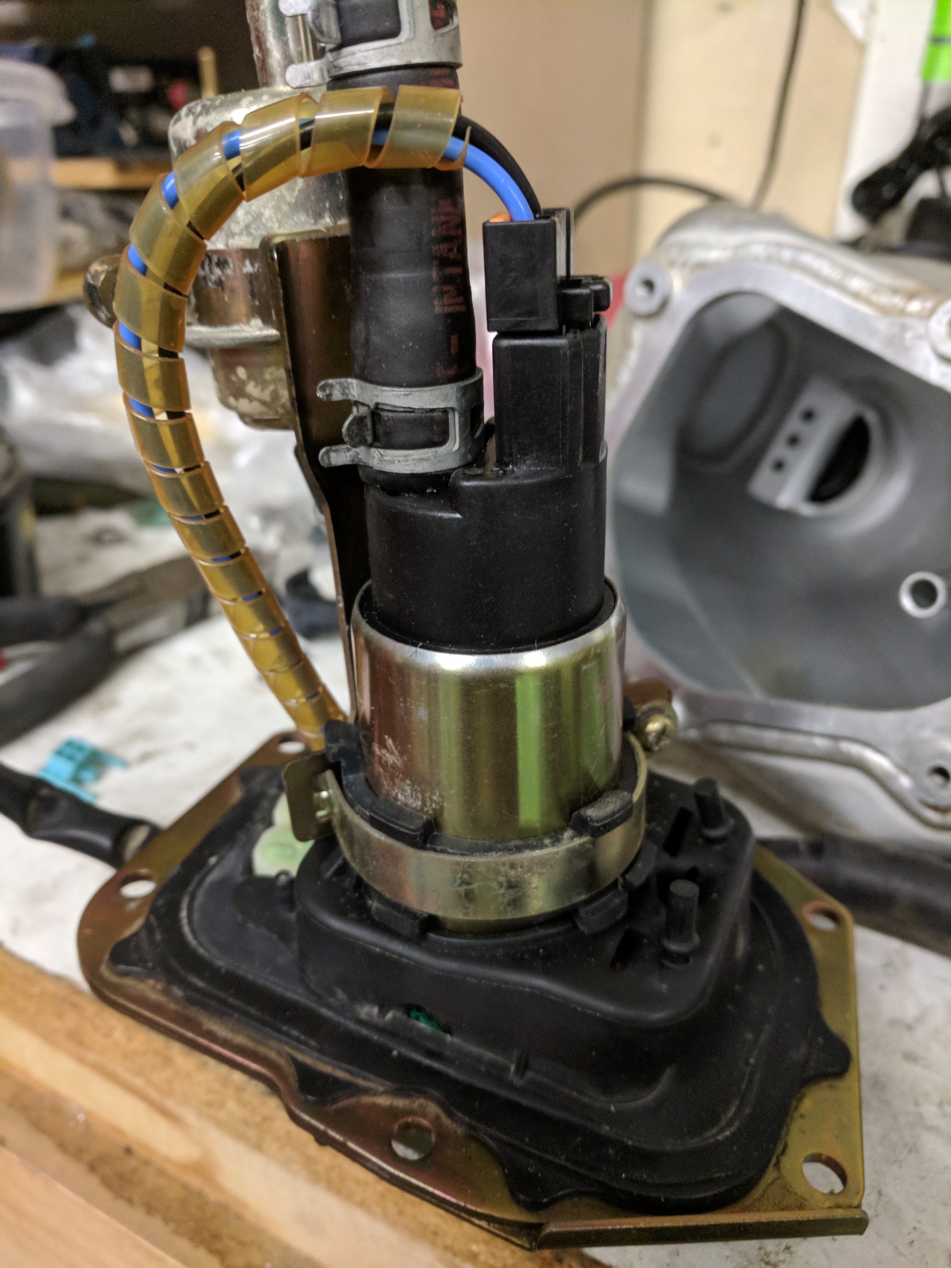

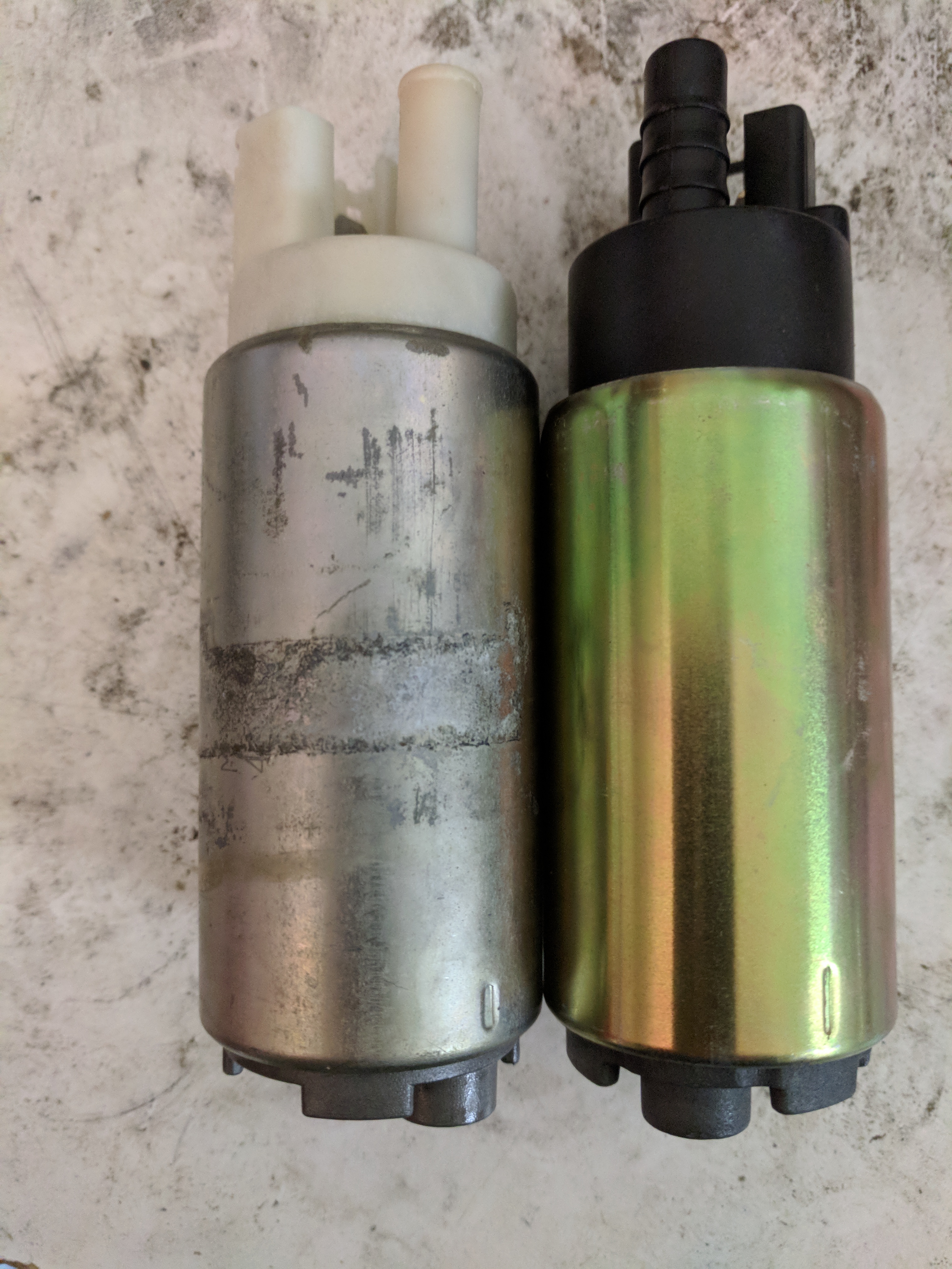

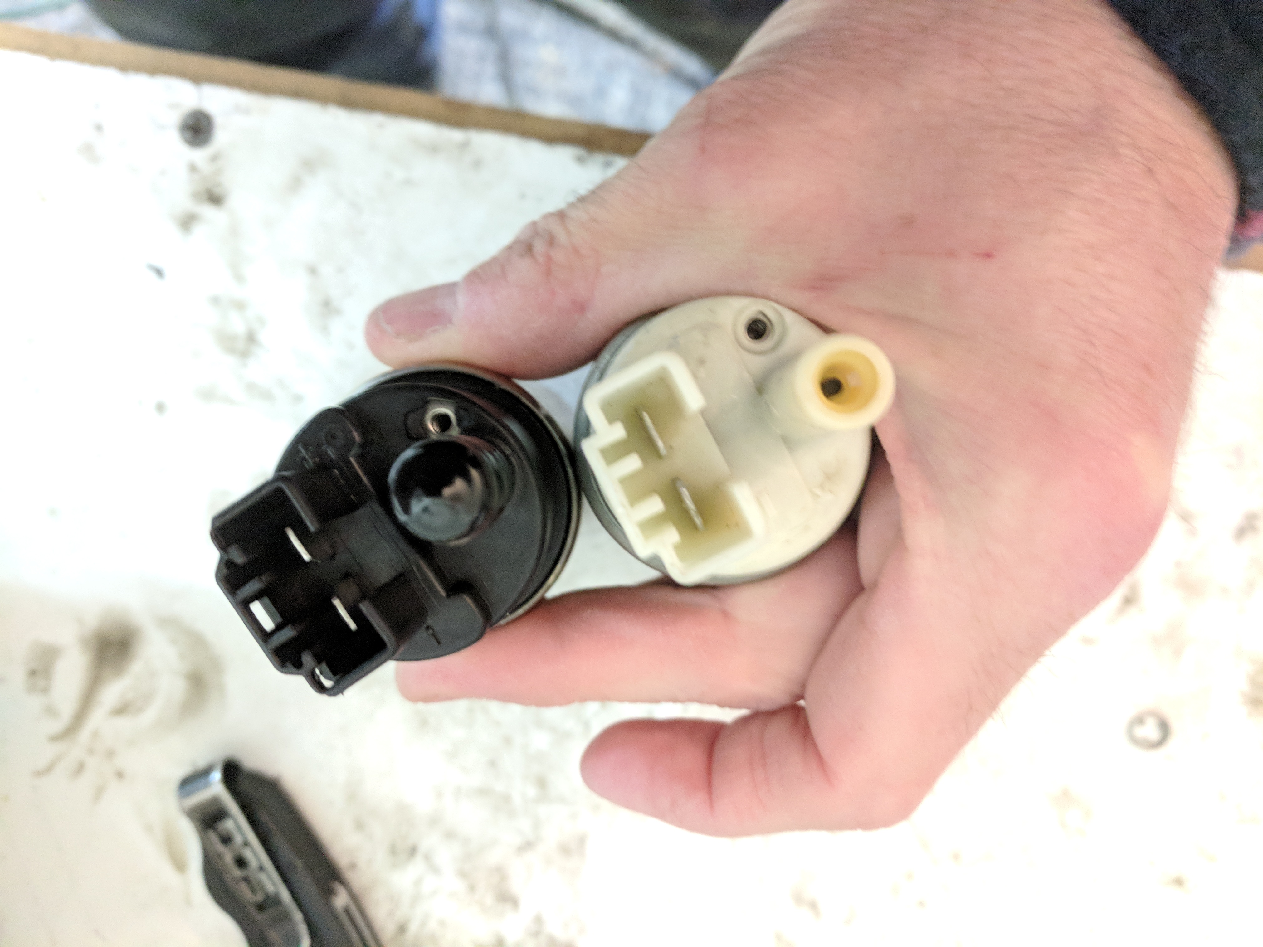

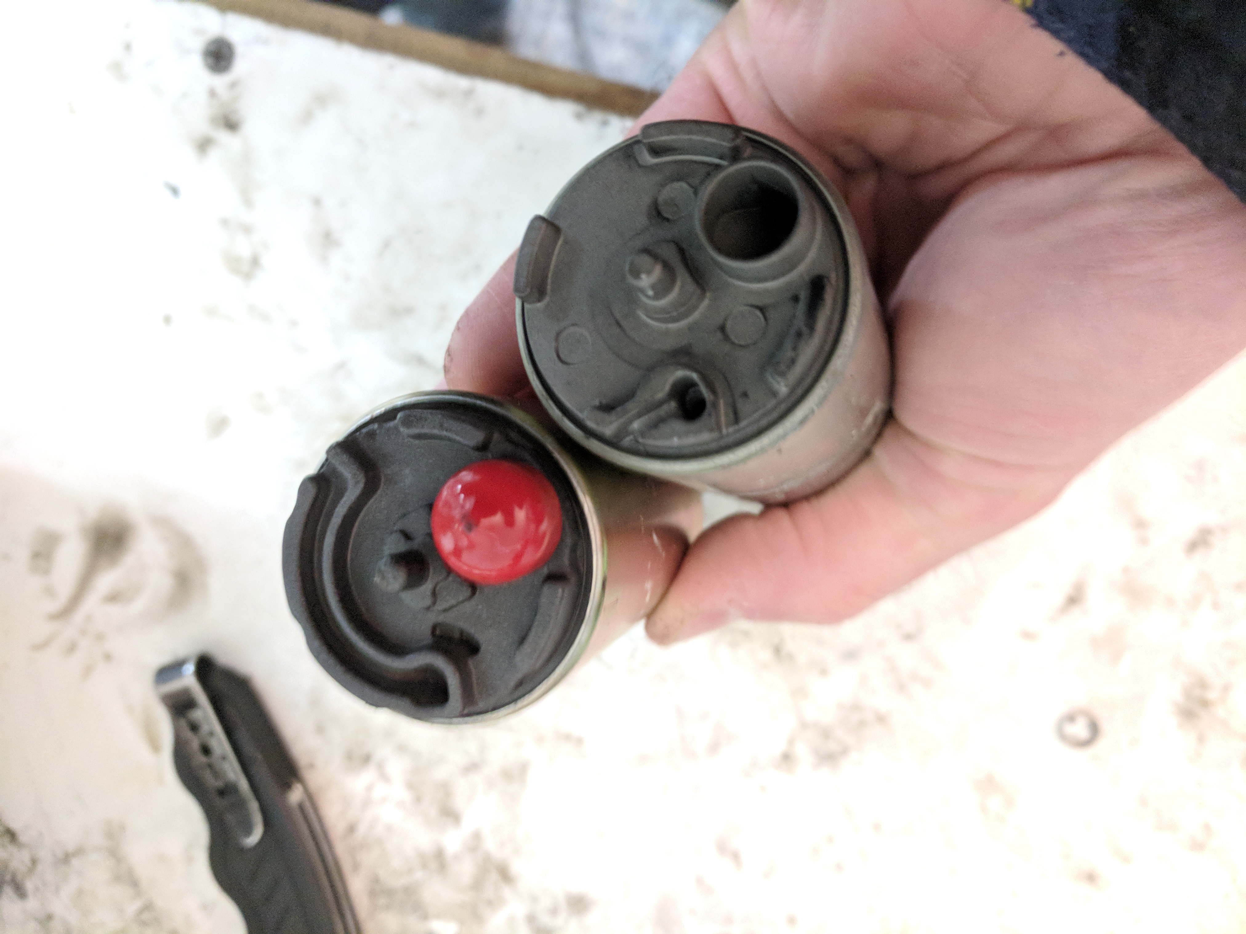

drew88 Posted December 7, 2017 Report Share Posted December 7, 2017 I found this thread when I was looking for options for replacing the fuel pump on my 2005 4RT. I'd thought I'd share what I found in case it could help someone else. I figured out that the fuel pump for a 2006 Honda CBR600F4i had the same dimensions and looked like the same connector as the pump in the 4RT, so I ordered one on amazon for $17. The fuel screen that comes with it was too big, so I re-used the old one, but it all works fine. much better than spending $1000. Here's some pics of the 2 pumps side by side. 3 Quote Link to comment Share on other sites More sharing options...
