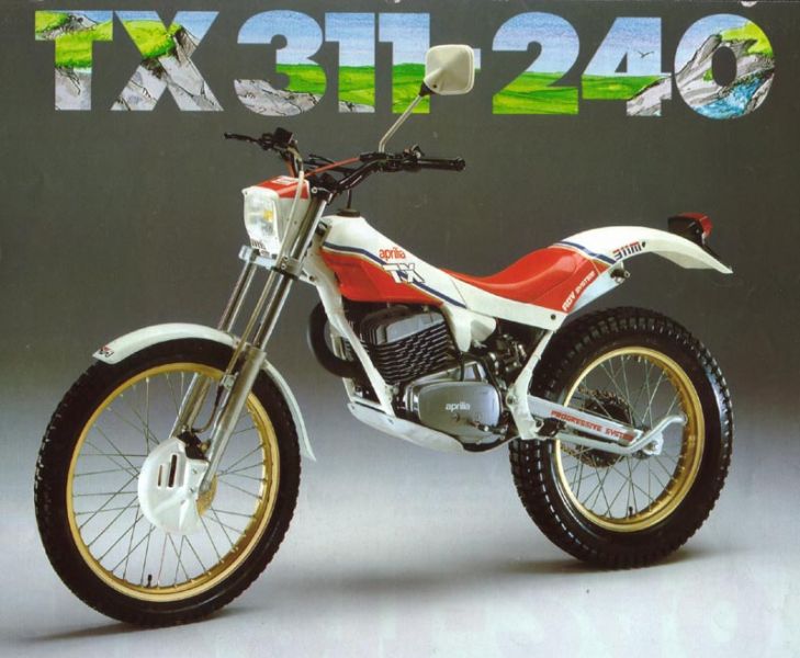

reginald Posted April 4, 2011 Report Share Posted April 4, 2011 Love to see some pics? Quote Link to comment Share on other sites More sharing options...
b40rt Posted April 4, 2011 Author Report Share Posted April 4, 2011 It looked like this, some time ago Quote Link to comment Share on other sites More sharing options...
