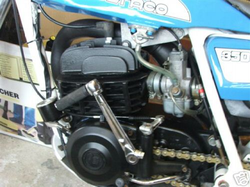

hewson Posted January 4, 2011 Report Share Posted January 4, 2011 Later headsteady from a 1982 199B 340 Quote Link to comment Share on other sites More sharing options...
nigel dabster Posted January 4, 2011 Report Share Posted January 4, 2011 Later headsteady from a 1982 199B 340 thanks my dear hewson, perhaps we can share the apology? What you must take into account, (are you in the usa?) sometimes you cannot swap a parts book for specialist knowledge. It may well have been an outsourced supplier who didn't get paid and someone decided to make the steady they always needed but it was a factory part fitted to the late 340's, period. Quote Link to comment Share on other sites More sharing options...

sherpa325 Posted January 4, 2011 Report Share Posted January 4, 2011 (edited) The standard pressed steel bracket will break if the bike is ridden in any sort of reasonable competition, if it is not repaired the frame will begin to bend, the backbone bends upwards and the front downtube bends inwards and hairline cracks will start in the downtube at the bottom engine mount and at the junction of the top triangular gusset and the downtube. All the 199B bikes I have seen have had the pressed steel bracket, so I would really like to see a detailed photo of the late factory alloy one fitted with the tank off. When I have seen photos of some english bikes with them fitted I just assumed they were a comerfords modification. Cheers Greg Edited January 4, 2011 by sherpa325 Quote Link to comment Share on other sites More sharing options...
pschrauber Posted January 5, 2011 Report Share Posted January 5, 2011 The standard pressed steel bracket will break if the bike is ridden in any sort of reasonable competition, if it is not repaired the frame will begin to bend, the backbone bends upwards and the front downtube bends inwards and hairline cracks will start in the downtube at the bottom engine mount and at the junction of the top triangular gusset and the downtube. All the 199B bikes I have seen have had the pressed steel bracket, so I would really like to see a detailed photo of the late factory alloy one fitted with the tank off. When I have seen photos of some english bikes with them fitted I just assumed they were a comerfords modification. Cheers Greg Yep, totally right, to avoid any overstraining to the headstay it is necessary to mount the complete cylinderhead / headstay assambly together. Bending the headstay down for getting the engine better out of the frame is a bad idea, (you will overstress the steelplate, which later will cause that it cracks). Just unscrew only the two fastenings of the cylinderhead for getting loose the headstay is also not recommended, you can "wrap" the head. This is the problem of this kind of bracket. BTW: Why the headstay is not mounted to Mr. Michauds former Bultaco is a miracle to me. Quote Link to comment Share on other sites More sharing options...
nigel dabster Posted January 5, 2011 Report Share Posted January 5, 2011 Yep, totally right, to avoid any overstraining to the headstay it is necessary to mount the complete cylinderhead / headstay assambly together. Bending the headstay down for getting the engine better out of the frame is a bad idea, (you will overstress the steelplate, which later will cause that it cracks). Just unscrew only the two fastenings of the cylinderhead for getting loose the headstay is also not recommended, you can "wrap" the head. This is the problem of this kind of bracket. BTW: Why the headstay is not mounted to Mr. Michauds former Bultaco is a miracle to me. ...........because you are totally missing the point!!!! It may well be that fred's bike had the steel one and it broke, or more likely the frame top tube was bent and leaving the steady ooff allows it to go back.(NB depends which way its gone i have seen both) lots of things went "unnoteded" during the last production runs perhaps you would know from the parts book which bikes had motoplat and which femsa ignitions as both were fitted to 340's? of course not. The alloy steady was fitted by the factory the bikes were not modded by comerfords. Quote Link to comment Share on other sites More sharing options...
