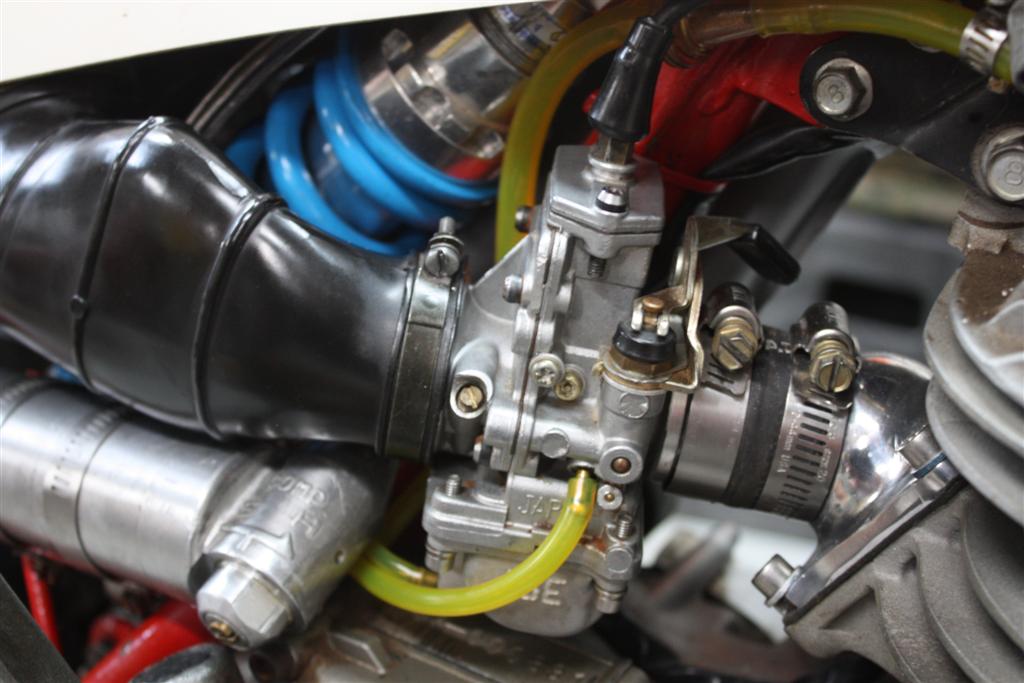

jse Posted January 7, 2011 Report Share Posted January 7, 2011 As long as we are in the carburation intake subject, my original carb seem's ok but what about a new Mikuni, and a few guy's run flatslide on Sherpa 350. Is it worth making the change ? Guy I think it depends on what result you want. I run a modified Mikuni flatslide on my TY350 (see photo) but when I had a Sherpa-T 350 I was quite satisfied with the Amal 900 concentric, even though a lot of my friends converted to Mikuni's. I think you need to decide what the engine is not doing for you rather than what other riders are using and that decision will dictate your modifications, if any. Jon Quote Link to comment Share on other sites More sharing options...
guy53 Posted January 7, 2011 Author Report Share Posted January 7, 2011 The carb on my 74 ty is original,I figure that '' it's not The carb it use to be ''. so I think it's time for a new one, but I never played around with the carburation on a trial , Boyesen # 652 are definitely in next the carb. Guy Quote Link to comment Share on other sites More sharing options...
