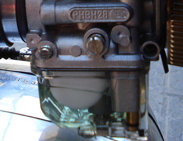

toofasttim Posted January 24, 2011 Author Report Share Posted January 24, 2011 I would break the carb over a collection bowl to see what comes out. Nothing like a fresh start! I should do that but I'm seriously tempted by one of these: Am a bit jealous BTW, like that bike and want one, maybe later, let us know how you get on with it! Will do Copey. Quote Link to comment Share on other sites More sharing options...

pistonbroke Posted January 24, 2011 Report Share Posted January 24, 2011 I should do that but I'm seriously tempted by one of these: Will do Copey. That is a fantastic idea and I want one as well !!! I love gadgets !! Phil Quote Link to comment Share on other sites More sharing options...
tony27 Posted January 25, 2011 Report Share Posted January 25, 2011 I've got 1 of those on my oko, great for seeing if water has gotten in there. Got told june last year that knocking around 200mm off end of breather fixes the kinking & clogging problems, seems thats how far the mud travels down the hose & with the shorter hose the exit is away from the crap Quote Link to comment Share on other sites More sharing options...

copemech Posted January 27, 2011 Report Share Posted January 27, 2011 re the clear bowls: I seem to recall sometime back that there was some issue with them, yet I cannot recall. Put me off them at the time though. Could have been the added material thickness causing an interferance with the enging cases. May have been fron Neo's works, let's see if he chimes in on this. Quote Link to comment Share on other sites More sharing options...
tony27 Posted January 27, 2011 Report Share Posted January 27, 2011 From memory the oko came a bit close to the cases on 1 of his carbs-possibly on the 125, he warned not to file the part that looked like a nut as the bowl is fairly thin there. Not a problem on my 290 as I have a different manifold Quote Link to comment Share on other sites More sharing options...
