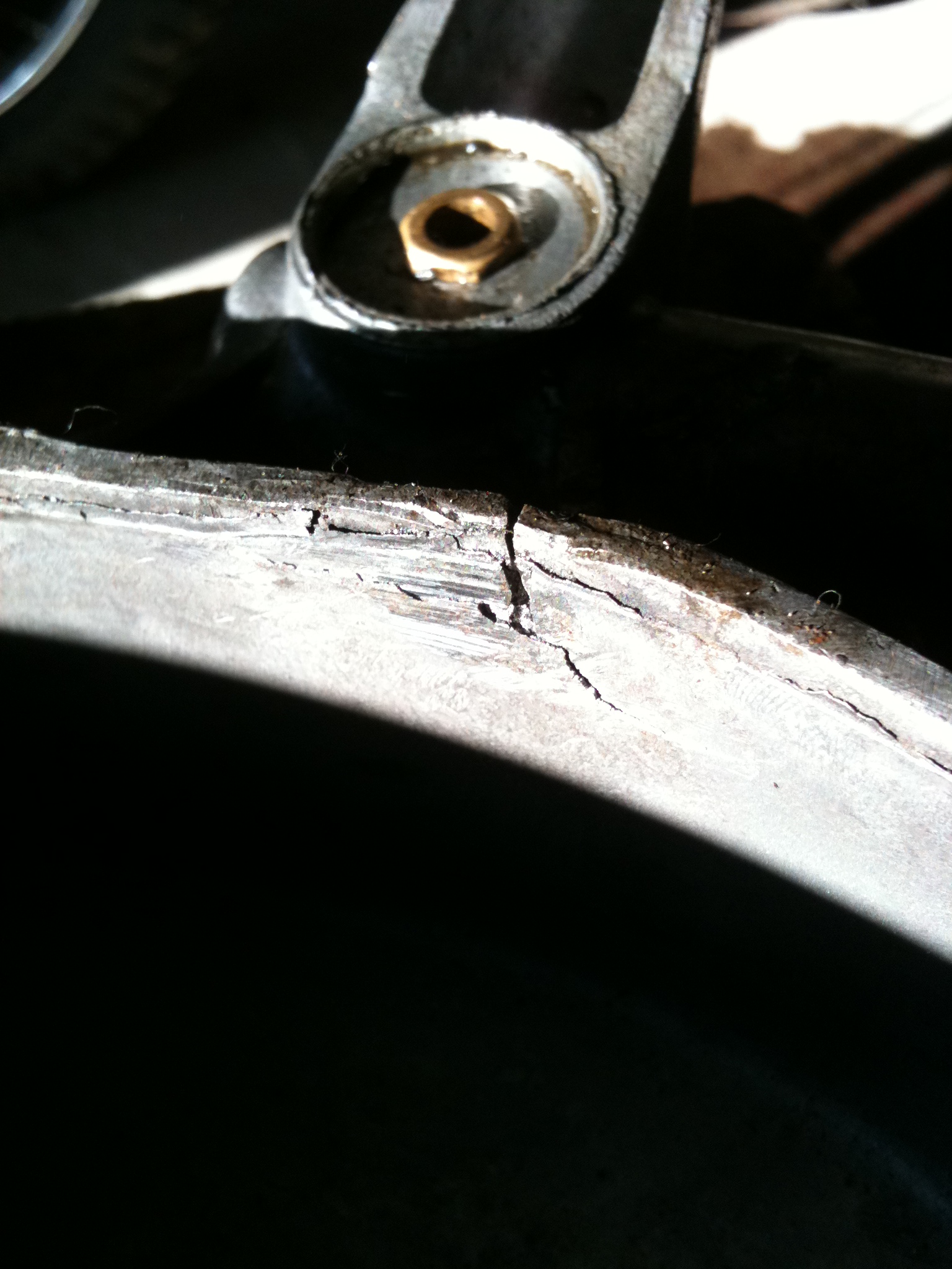

insultaco Posted January 28, 2011 Author Report Share Posted January 28, 2011 Mag cover and crank case. After pictures to follow. Cheers Mick Quote Link to comment Share on other sites More sharing options...
tomtom385 Posted January 31, 2011 Report Share Posted January 31, 2011 Mag cover and crank case. After pictures to follow. Cheers Mick Ouch Mick, Thats a nasty bit of chain rash on the casings there. go easy on the Mag cover, looks a bit thin in places. i was lucky when i brazed my tank as it was all uniform. i dont know if there is any store in bunging it in the misses's oven on the hotest it will go, may help out when applying some serious heat. hope it goes well. Regards, tom, Quote Link to comment Share on other sites More sharing options...
