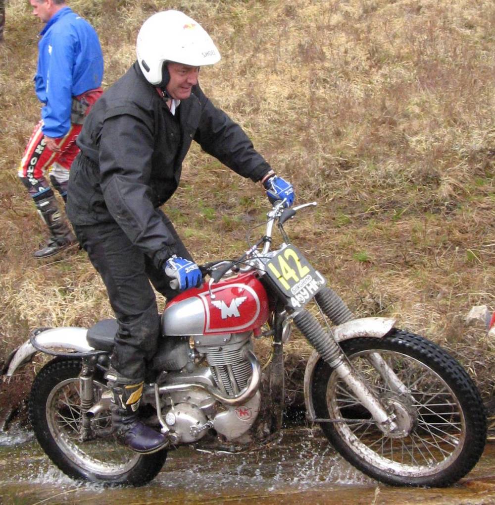

We're trying to strip a pair of Matchless forks, similar to those in the picture.
Top nuts are off, springs and spring covers are off. The bolt at the bottom of the slider is out.
How does the stanchion come out of the slider? It won't just slide out, it is as though something is still holding it. There is a damper rod (or whatever) only a few millimetres in diameter, sticking out of the top of the stanchion, this also seems held in by something. It will turn but doesn't unscrew.
I've tried sharply pulling the stanchion out of the leg but it hits what feels like a rebound cushioning spring and won't come out. I'm now stumped.
Can anyone tell me how to remove the stanchion from the leg please? Any assistance appreciated.

I think I recognise the front wheel in the photo, that is one of mine!
Yes heat up the top of the slider with a hot air gun, especially the slightly wider part all the way round, not too hot but just so that you touch it without burning yourself. Clamp slider in a vice with thick rags to protect the alloy and pull the stantion up hard, quite a few times, there is a bakelite or possibly nylon bush in the wide part of the slider and there is a steel bush circlipped on the bottom of the stantion, you effectively tap out the nylon top bush with the upward movement of the stantion. Watch out they usually break free in an instant - showering you with oil and gunge, so wear protective clothing and eye goggles!

Yes it is your bike John, a picture from the Pre65 Scottish a few years ago.
