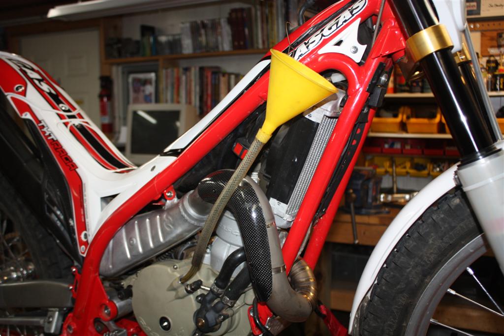

exobyte Posted February 3, 2011 Author Report Share Posted February 3, 2011 Hi Andy! As you have found, it can be really confusing, especially for the early models as I don't think there were hardcopy owner's manuals available (until early 2000 maybe?) (I never got one with my 96' 370). From my experience and all the information I have gathered, here's what seems to work well in your 97': ATF (Dexron automatic transmission fluid) or a light, non-synthetic motor oil. ATF is around 7.5 weight and a lighter viscosity oil works better with Trials clutches. I always used the Dexron in my 96' with very good results and changed it about every 10-15 hours of use or after a wet Trial. The factory recc. is 700cc's but 650cc's seems to give slightly better clutch action for some reason. From what I understand, the reason full-synthetic is not recommended is that the factory that makes the fiber plates (in Germany, I think) has reason to believe that moisture reacts with some synthetics and creates an acid condition that may attack the bonding agent holding the fiber to the steel plate. Putting oil back in the engine is a real pain. I've always used this funnel/hose thingy I made that attaches with a wire to the fuel cap. It has saved me countless spills. The drainplugs are aluminum and strip easy so use a new Allen wrench or cut 5mm off the tip of an old one. Allen tips wear with use (the flutes round off) and most complaints of poor capscrew material stripping out is really the result of a poorly maintained tool. http://www.trialspartsusa.com/tech.html has a lot of good information for your bike and will prove helpful. Jon Thank you and everyone else that has helped me out, think the funnel modification thing is a great idea and will be making myself one. Thanks again, Andy. Quote Link to comment Share on other sites More sharing options...
