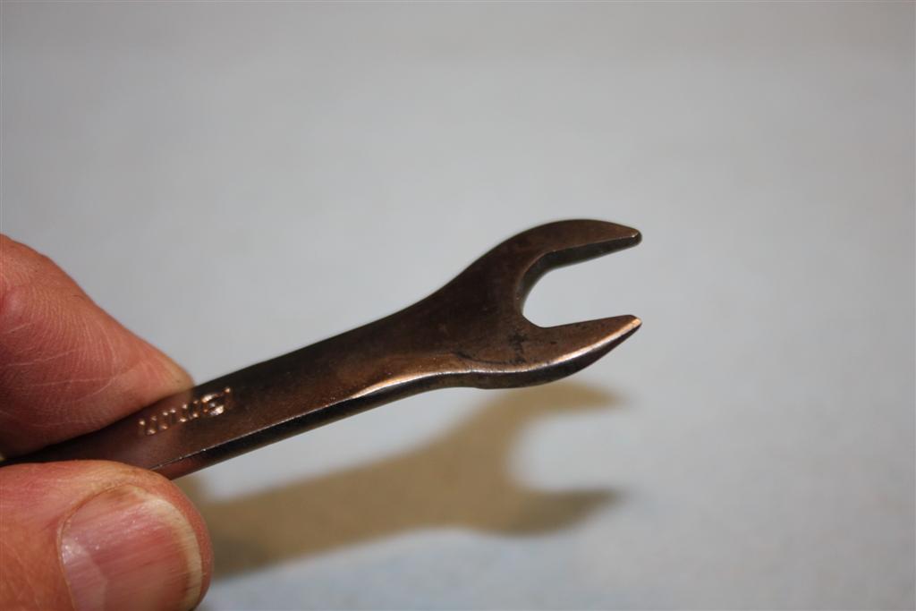

I usually just snug them up tight also. The torque setting are 13-18 ft lbs (18-25 Nm). As long as the Nyloc nuts are in good shape they should hold. A handy tool to make is to thin an old 13mm (1/2") spanner and then you can just lay the bike over and check those front fasteners now and then. The thin spanner fits in between the bolt head and the shock mount and allows you to hold the head of the bolt and tighten the outside nut.
