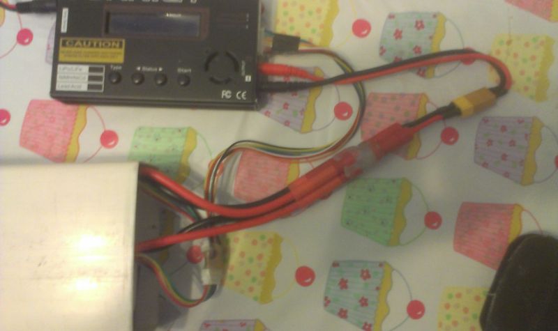

For a 36v setup then 2x5s in series will give you around 41v hot off the charger ( this is fine and will make the bike have a little more top end ) ,
If you have 2 chargers then either pairs of 5s ( for 36v ) or pairs of 6s ( for 48v ) makes the easiest way to charge the battery's. Once you start looking at chargers to 6+ cells these become a lot more expensive.
if putting battery's in series and/or in parallel then they should all be the same capacity and all the individual cells need to be in good condition ( balanced ) .
2x 5s1p 5000mah in parallel = 18.5v 10ah lipo , treat this as one battery
you connect 2 of these 18.5v battery's in series to make the 37v 10ah battery.
either hardwire the 2x5s battery's in parallel or you can make plug adaptors to fit the 2 5c battery's together.
here are the connections/plugs that you require to wire up either a 36v or a 48v setup.
There are many ways to do this but this is how I do it.
