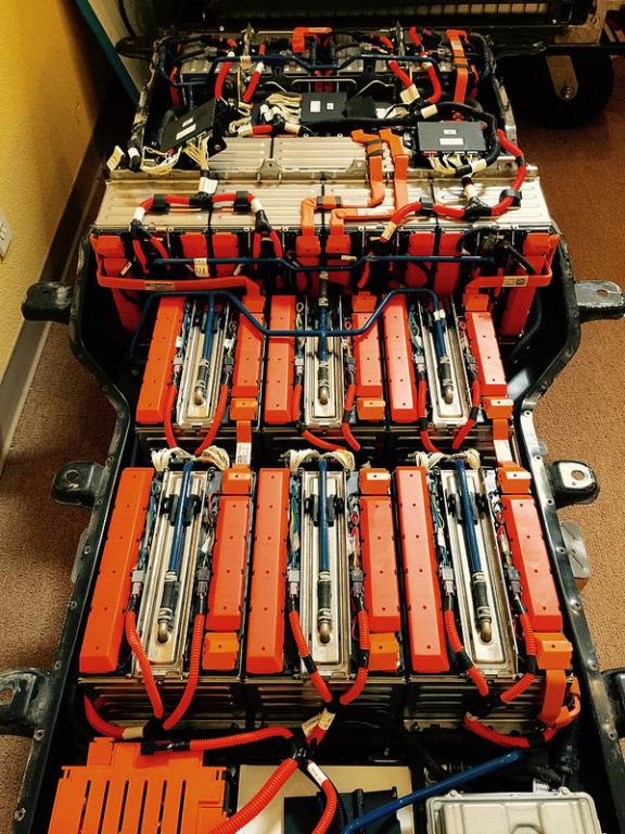

greg555 Posted October 10, 2016 Report Share Posted October 10, 2016 I have my sons 12.5 running on a 6s4p 18650 cell pack (made from salvaged Tesla cells). Theoretically it should be a little less sensitive than a lipo pack. No BMS at present so I charge with an RC balance charger and leave a cell checker/of alarm on the balance plug when in use. Total weight is 3lbs and it shod be good for about 12ah. Can u post a picture? So funny, today I thought about this thread because im in the process of taking apart a Fiat 500e battery and was thinking if these cells would fit my boys Oset 16's Quote Link to comment Share on other sites More sharing options...
bikepilot Posted October 11, 2016 Report Share Posted October 11, 2016 Wow that's cool! Ill have to take a picture. Right now it's just a wrapped 18650 pack. There is a fellow on endless sphere who sells the Tesla cells and he was nice enough to put the pack together. What sort of cells does the Fiat use? Quote Link to comment Share on other sites More sharing options...
greg555 Posted October 11, 2016 Report Share Posted October 11, 2016 Bosch Quote Link to comment Share on other sites More sharing options...
