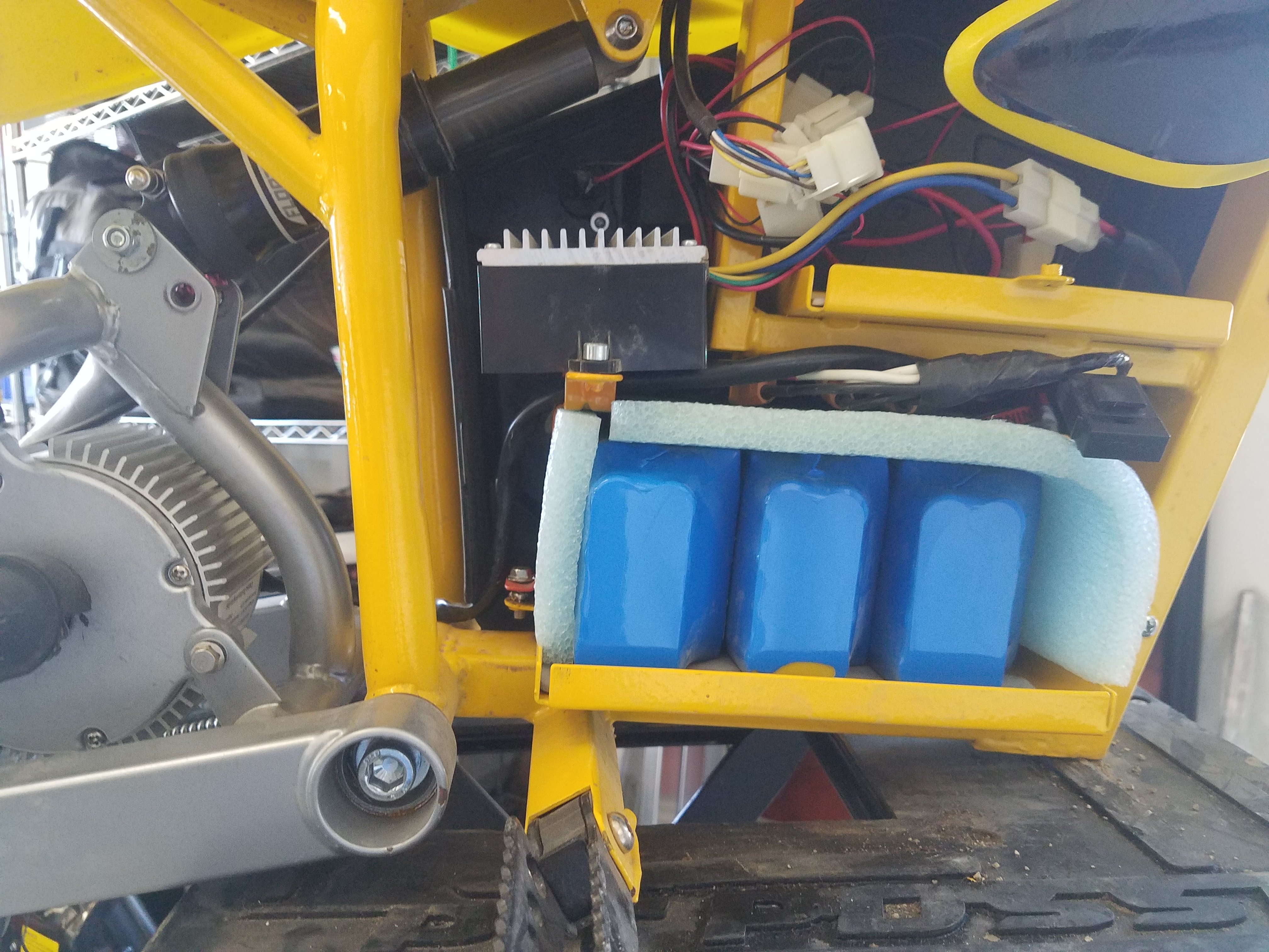

Yrocmoto Posted March 8, 2020 Report Share Posted March 8, 2020 (edited) For the 36v bikes I would try these for a cheap solution: https://www.ebay.com/itm/UFO-U18650-36V-158-4Wh-Battery-10s2p-for-Hoverboard-Balance-Board/323334808752 I don't have a 36v Oset, but I used these to upgrade an electric Razor MX500 bike with a 1000w 36v Currie motor and it's been working awesome for over 2 years. I have 3 of these in parallel and a 42v Lithium charger, it will go forever and do 16 miles around town, it's been great and I just plug it in to charge, no messing with packs and balancing or alarms... so just a thought for your guys... Edited March 8, 2020 by Yrocmoto Quote Link to comment Share on other sites More sharing options...
brianjonesphoto Posted March 9, 2020 Report Share Posted March 9, 2020 On 3/8/2020 at 10:30 PM, Yrocmoto said: For the 36v bikes I would try these for a cheap solution: https://www.ebay.com/itm/UFO-U18650-36V-158-4Wh-Battery-10s2p-for-Hoverboard-Balance-Board/323334808752 I don't have a 36v Oset, but I used these to upgrade an electric Razor MX500 bike with a 1000w 36v Currie motor and it's been working awesome for over 2 years. I have 3 of these in parallel and a 42v Lithium charger, it will go forever and do 16 miles around town, it's been great and I just plug it in to charge, no messing with packs and balancing or alarms... so just a thought for your guys... Expand Do these have an internal BMS? Quote Link to comment Share on other sites More sharing options...
Yrocmoto Posted March 10, 2020 Report Share Posted March 10, 2020 (edited) On 3/9/2020 at 4:51 AM, brianjonesphoto said: Do these have an internal BMS? Expand YES!! Just use a charger like this: https://www.ebay.com/itm/Universal-Charger-Adapter-For-Hoverboard-Smart-Balance-Scooter-2-Wheel-42V-2A-US/273386670265?epid=13026675911&hash=item3fa71d88b9:g:4WcAAOSwmrpbfmVY Edited March 10, 2020 by Yrocmoto Quote Link to comment Share on other sites More sharing options...
greg555 Posted March 10, 2020 Report Share Posted March 10, 2020 On 3/8/2020 at 10:30 PM, Yrocmoto said: Expand Is it me or do these packs look really swollen????? Quote Link to comment Share on other sites More sharing options...
gwhy Posted March 10, 2020 Report Share Posted March 10, 2020 On 3/10/2020 at 4:42 PM, greg555 said: Is it me or do these packs look really swollen????? Expand it looks like they are cylindrical cells not pouches .. but could be wrong.. but if they are pouches then there is something very wrong with them Quote Link to comment Share on other sites More sharing options...
Yrocmoto Posted March 24, 2020 Report Share Posted March 24, 2020 They are cells, they are fine. They look "swollen" because the BMS is shorter than the pack of cells which makes it a bit of an odd shape (tapers up to the BMS) 1 Quote Link to comment Share on other sites More sharing options...
