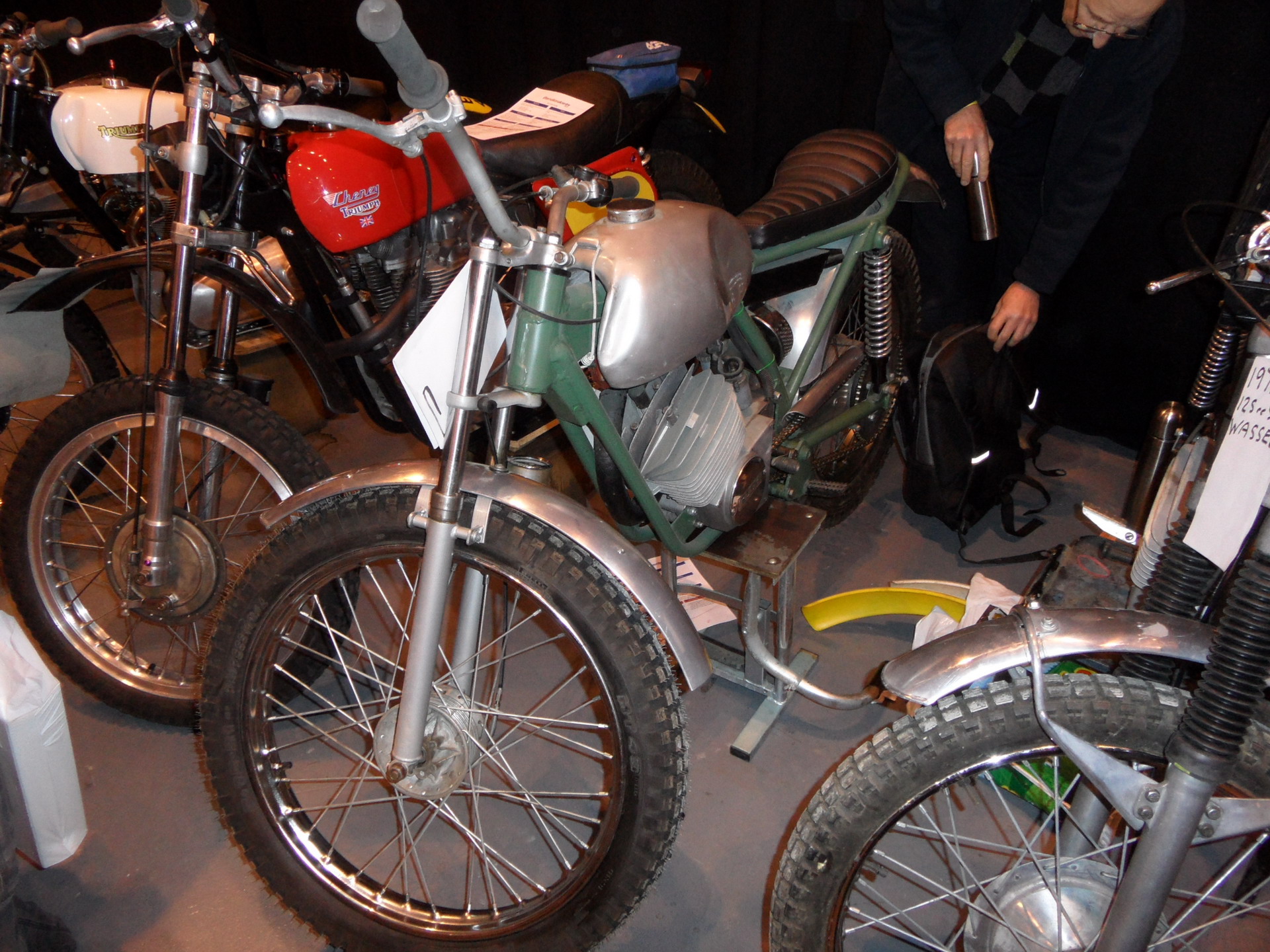

stickinthemud Posted February 16, 2011 Report Share Posted February 16, 2011 Very badly. Old fibreglass will desolve very quickly. You can try to line it or better still get an alloy one. Take a look at this and several previous topics.. Just search for ethanol. Is this one of the ones you bought? It was at the show last weekend. Quote Link to comment Share on other sites More sharing options...
big john Posted February 16, 2011 Report Share Posted February 16, 2011 Very badly. Old fibreglass will desolve very quickly. You can try to line it or better still get an alloy one. Take a look at this and several previous topics.. Just search for ethanol. Is this one of the ones you bought? It was at the show last weekend. I saw that bike, mark 1 Dalesman Puch from 1968/69, with the Puch moped forks and front hub, would look good with a set of stickers on it, mind you that version had a green sticker with the original green and black Puch emblem. Big John Quote Link to comment Share on other sites More sharing options...
treevor Posted February 16, 2011 Author Report Share Posted February 16, 2011 Howdo Guys, I saw that one to and took loads of pictures but its not what I bought. One of mine has an alloy tank with nice stickers on it Big John but I will have some off you for spares, let me know what you want and I will dosh you up. Mine came from Cumbria and there are two complete bikes and an extra engine, four spare barrels with heads and pistons, four spare wheels, three spare ignitions and two sets of spare forks, oh and a couple of spare carbs, one Bing and one Concentric with a manifold. He threw in a set of betor forks and some old chrome rims as well. I will use the fibreglass tank to make a mold I think and then see if I can seal it with the Caswell stuff. The best thing for me though was getting the manual with it, that means I don't have to pull an engine in bits to see how it is put together and take pics. Anyone want a copy I'm sure we can come to some arrangement. Is the Green in the pic an original colour? mine is more Italjet/Kawasaki green and I want to take it back to standard. The tank/seat unit is light blue, what colour frame would of gone with that? Thanks for help so far guys, any other info will be appreciated, I may even do the rebuild in a blog on here Trevor Quote Link to comment Share on other sites More sharing options...
big john Posted February 17, 2011 Report Share Posted February 17, 2011 The green paint on the frame of the bike in the photo is very close to the original colour. There was once a Tractol enamel that was a close match, I think it may have been called Mid Green. Send me a PM with your e-mail and I'll keep you informed about the tank decals. Big John Quote Link to comment Share on other sites More sharing options...
