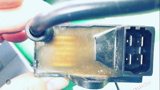

Teru Posted February 2, 2018 Report Share Posted February 2, 2018 Hi,all I have own Aprilia Climber 240. Also lost the spark , checked the plug, took the flywheel off and cleaned everyparts, coil and burn-in. Eventually I made a conclusion that *doesnt work the condenser (ECU). I have a one question. Please advice me how to remove the condenser that silicon bounded in the ECU box (CDI).. Any suggestions ? Teru Quote Link to comment Share on other sites More sharing options...
b40rt Posted February 2, 2018 Report Share Posted February 2, 2018 Try http://www.motoswm.co.uk/product-category/ignition/page/2/ Quote Link to comment Share on other sites More sharing options...
turbohead Posted February 4, 2018 Report Share Posted February 4, 2018 The Rotax engines were a bit late to get modern ignition systems, compared to other European engines of the '80s. However, they can still be made to work today like they were all those years ago if you perform the daily routines as described above, over and over again. Points and condenser often cause problems, just like they did in the old days. However, if you are prepared to spend the money, an electronic ignition is better, give more consistent performance and is a fit and forget solution when done right. There are a few suppliers around and the price is €300-€450 for a complete kit, less if you need ignition only (no lights). But how are you going to spend all that time in your workshop if you don't need to adjust points and change other parts on a regular basis anymore....? Quote Link to comment Share on other sites More sharing options...
Teru Posted February 12, 2018 Report Share Posted February 12, 2018 On 2018/2/2 at 5:38 PM, Teru said: Hi,all I have own Aprilia Climber 240. Also lost the spark , checked the plug, took the flywheel off and cleaned everyparts, coil and burn-in. Eventually I made a conclusion that *doesnt work the condenser (ECU). I have a one question. Please advice me how to remove the condenser that silicon bounded in the ECU box (CDI).. Any suggestions ? Teru Hi all I’m so sorry that I can’t reply at once. Thank you foy some good advices and I was overwhelmed with several advices. Then My ECU was mounted to other Aprilia Climber so that I can check again my ECU unit.F It was good working order! Next step, I measured zero-power ohmic value of the exciter coil (generator). I found out some trouble and slightly malfunction. My exciter coil 320Ω (common 800Ω). I could fix my generator by replace the exciter coil. Thank’s a lot ! It’s done. Quote Link to comment Share on other sites More sharing options...
