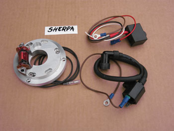

woody Posted March 5, 2011 Report Share Posted March 5, 2011 They are different designs but probably achieve the same result. The Bultaco UK one is much easier to fit as it has a fixed stator position and then a three way adjustment for static timing position. The Electrex ignition sounds very time consuming from the advice given above. Rex Caunt also does one (possibly the same as the Bultaco UK ignition) Quote Link to comment Share on other sites More sharing options...
motovita Posted March 5, 2011 Report Share Posted March 5, 2011 a fixed stator position and then a three way adjustment for static timing position. Can you explain that adjustment? I can't picture it in my head. Quote Link to comment Share on other sites More sharing options...
woody Posted March 5, 2011 Report Share Posted March 5, 2011 Can you explain that adjustment? I can't picture it in my head. The backplate is a fixed position with screw holes instead of slots to fix it to the crankcase. Another plate with the source coil attached is screwed to the backplate. The positioning of this plate onto the backplate is set by the manufacturer to the recommended setting. However, it is adjustable as the fixing screws sit in slots which have 3 notches so the plate can be rotated left or right of the centre notch to fine tune the timing to individual preference. If it is the same as the Rex Caunt one, you have a choice of locating holes in the backplate (3 I think) So by using the far left holes the ignition can be further retarded, by using the far right holes it can be further advanced. So basically, you fit it, fire it up and try it. If it is ok you leave it, if you want it sharper you can advance it, softer you can retard it by rotating the second plate on its fixing screws. Hope this makes sense, maybe the attached picture explains it better Quote Link to comment Share on other sites More sharing options...
