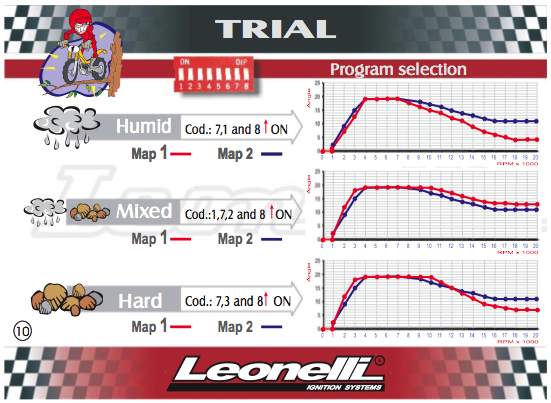

splatshop Posted March 21, 2011 Report Share Posted March 21, 2011 This shows the differences between the 2 different maps, as you can see all the trial maps available are very similar at idle speed and only really change at around 10,000rpm. 1 Quote Link to comment Share on other sites More sharing options...
neo Posted March 21, 2011 Report Share Posted March 21, 2011 This shows the differences between the 2 different maps, as you can see all the trial maps available are very similar at idle speed and only really change at around 10,000rpm. 10,000rpm??? ... I didn't think a Trials bike rev'd up anywhere near that high Best of balance. Neo Quote Link to comment Share on other sites More sharing options...
chewy Posted March 21, 2011 Report Share Posted March 21, 2011 This shows the differences between the 2 different maps, as you can see all the trial maps available are very similar at idle speed and only really change at around 10,000rpm. What are the graphs showing? Why can't the maps be made nore different at revs where mere mortals(most of us) would find a benifit? What does 10,000 RPM on a trials bike sound like? (i'm waiting for som wag to say....BANG) Quote Link to comment Share on other sites More sharing options...
baldilocks Posted March 21, 2011 Author Report Share Posted March 21, 2011 (edited) so Map 2 is only the softest, as in less power per rpm on two of the 3 maps but the change is probably marginal looking at the graph until you get way beyond what I'll ever rev it to. Chris do you know which of the 3 applies to the 2011 bike out of interest ? its a good point though Chewy, why not change it at 3000 rpm, I doubt cabestany ever gets to 10,000 never mind Joe Public. Edited March 21, 2011 by Baldilocks Quote Link to comment Share on other sites More sharing options...
copemech Posted March 22, 2011 Report Share Posted March 22, 2011 Thanks again to Splatshop Chris for bringing out the Leonelli graphs for phe programmable ignitions(which could be adapted, yet the standard bike does not come with this, only the dual map. I highly suspect that the actual functions of the standard dual map are closely related to the advance curves illustrated, which also explains my lack of "seat of pants" resopnse. As my '07 did not have the switch, I have not been keen on the idea of retro fitting one. If anythin, I may be more inclined to "ditch the switch" myself. Or just make one them stickers to put on it a non-functional switch that says "EASY" to see if that will help my sorry ass any. Leonelli also states the limits on the trials flywheels at 13,000 rpm, with 14,000 as occasional limit! At 10K, she is singing! Bottom line-----FAIL!!!!!!!! IMHO! Quote Link to comment Share on other sites More sharing options...
