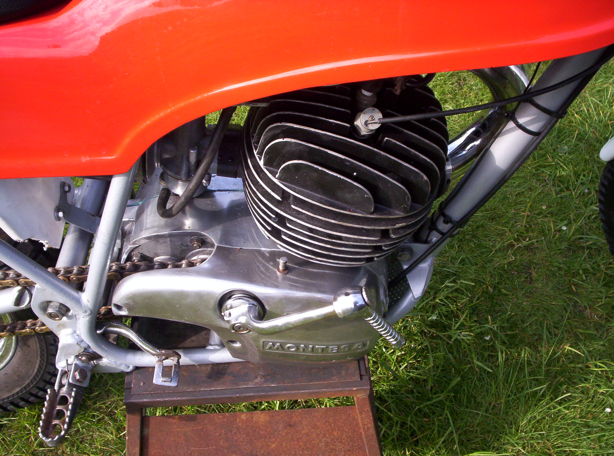

woody Posted June 22, 2011 Report Share Posted June 22, 2011 Something has been bent or modified as they shouldn't touch. I've owned a couple and ridden a few, there isn't a problem with clearance. Are you sure the kickstart is the right one or the pedal hasn't been altered. Below is a picture of my last one (footrests were moved if you think something doesn't look right) You can see the bend of the kickstart (this is how they are, I don't mean I bent it) See how it compares with yours. Decompressor kit should be available from most dealers such as BVM, Sammy Miller, Bultaco UK, Steve Goode. I think Venhill may stock them as well. If you fit one don't forget to use the spacer as the Mont is a short reach plug head and if you screw the decompressor right in it will clatter the piston and you'll have more than a brake pedal to worry about Quote Link to comment Share on other sites More sharing options...
keychange Posted June 23, 2011 Report Share Posted June 23, 2011 Mine did hit the brake pedal (and broke it) when I first got it and the advice I received was that the start levers bend with years of works and have to be straightened - that is what I did with mine (just heat it and straighten it) and now even with wide pegs I have plenty of clearance Quote Link to comment Share on other sites More sharing options...

for artie Posted July 7, 2011 Report Share Posted July 7, 2011 \it looks like you foot peg mount have been modified (lower and back) whoever did this may have moved the brake pedal pivot point and that is now why it hits the kick start. if you can you show a picture of the inside part of the frame I can confirm. Quote Link to comment Share on other sites More sharing options...
jimbo349 Posted July 7, 2011 Report Share Posted July 7, 2011 \it looks like you foot peg mount have been modified (lower and back) whoever did this may have moved the brake pedal pivot point and that is now why it hits the kick start. if you can you show a picture of the inside part of the frame I can confirm. The picture is not the OP's bike but an example of kickstarter shape Quote Link to comment Share on other sites More sharing options...
