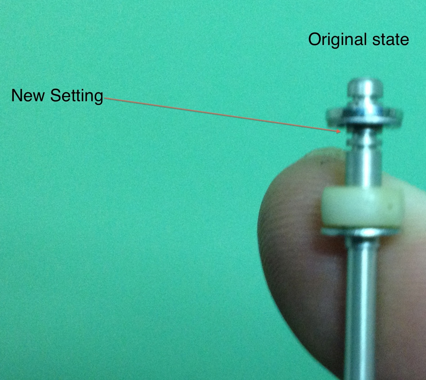

rollo Posted January 15, 2012 Author Report Share Posted January 15, 2012 Mine was exactly the same. The bikes come with jetting that is way too lean, and causes this problem. The carb is the same as that used on the Yamaha Raptor, so you can get parts from the Yamaha shop. You want to start here: Pilot jet: 22.5 Main jet: 130 to 135 Air screw: 2 3/8 turns out Needle clip: 2nd slot down from the top (thick washer below clip and thin washer above) Once done, it was a totally different bike and ran smooth as silk, with perfect idle. @DGShannon I've cleaned my carb and made a picture of the needle, is this the setting you mentioned? I've changed the clip to the position marked with the arrow. In my opinion this way the needle gets more lifted, so a richer mixture gets in the engine. Quote Link to comment Share on other sites More sharing options...
nzralphy Posted January 17, 2012 Report Share Posted January 17, 2012 Put the clip on the bottom so the needle is raised right up and the bike will have a much stronger mid range Quote Link to comment Share on other sites More sharing options...
