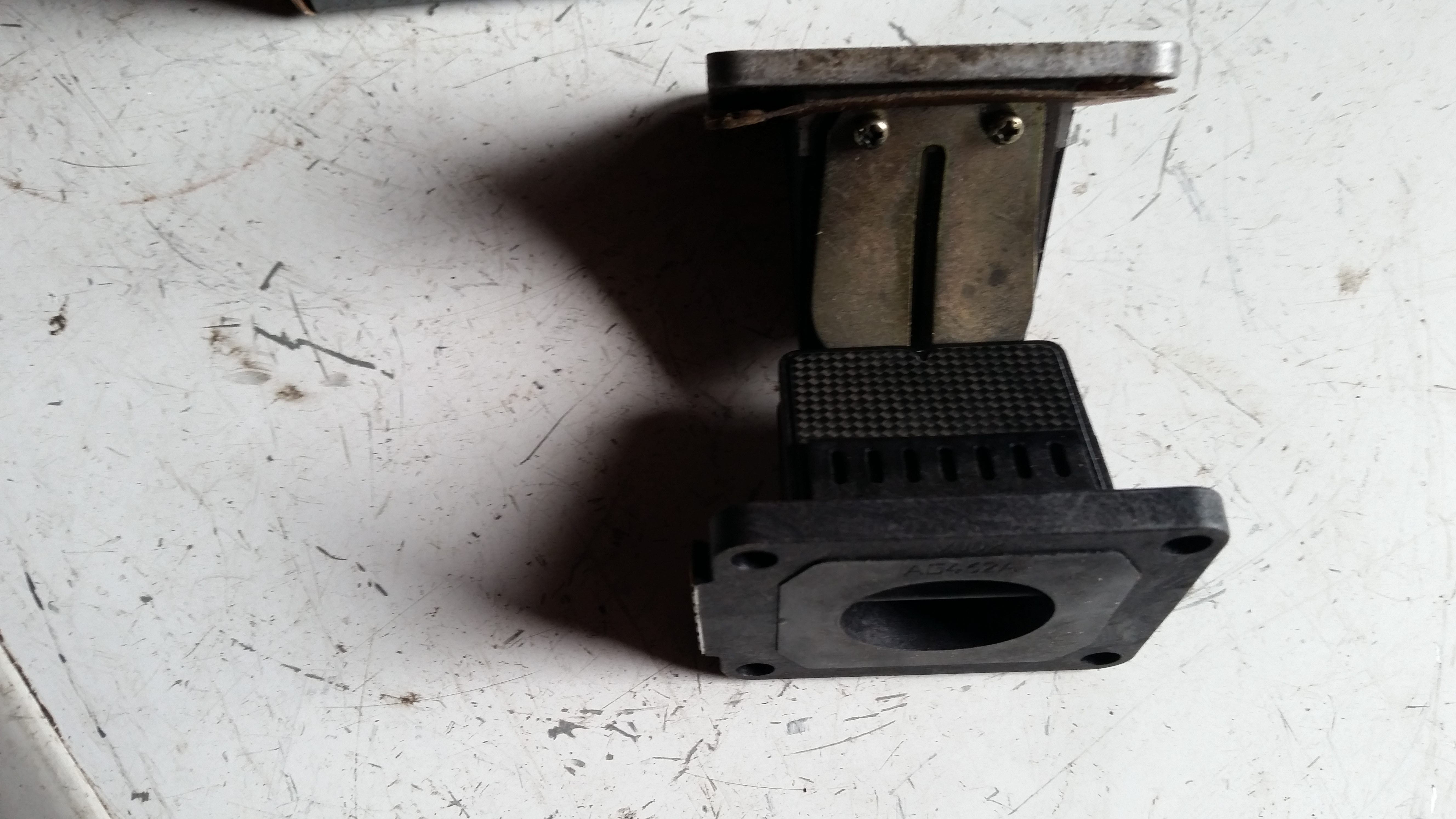

tony27 Posted July 25, 2011 Report Share Posted July 25, 2011 I'm pretty sure the reed valve in the TY250 is the same as a DT250 of the same age which may make it easier to find out Quote Link to comment Share on other sites More sharing options...

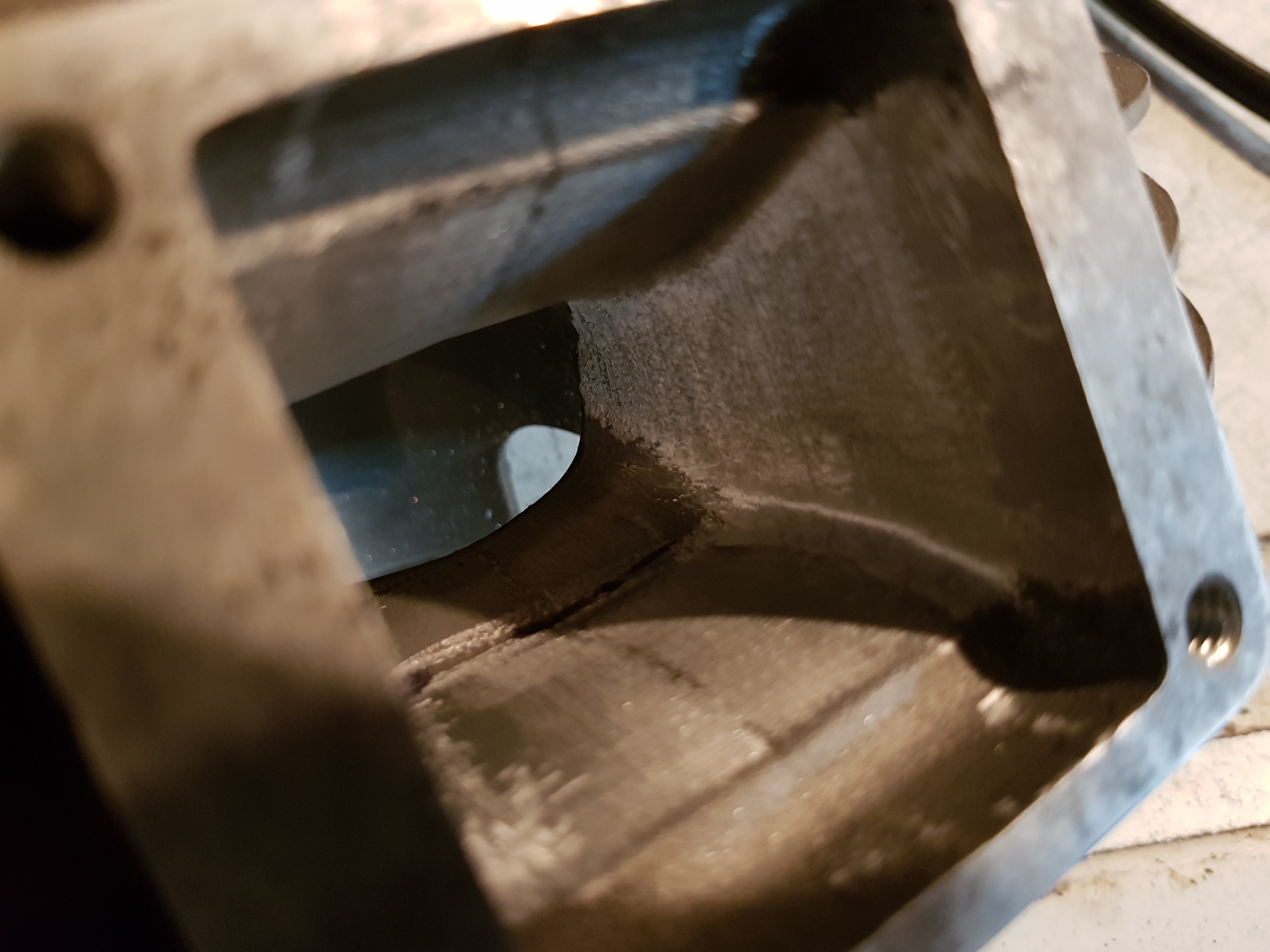

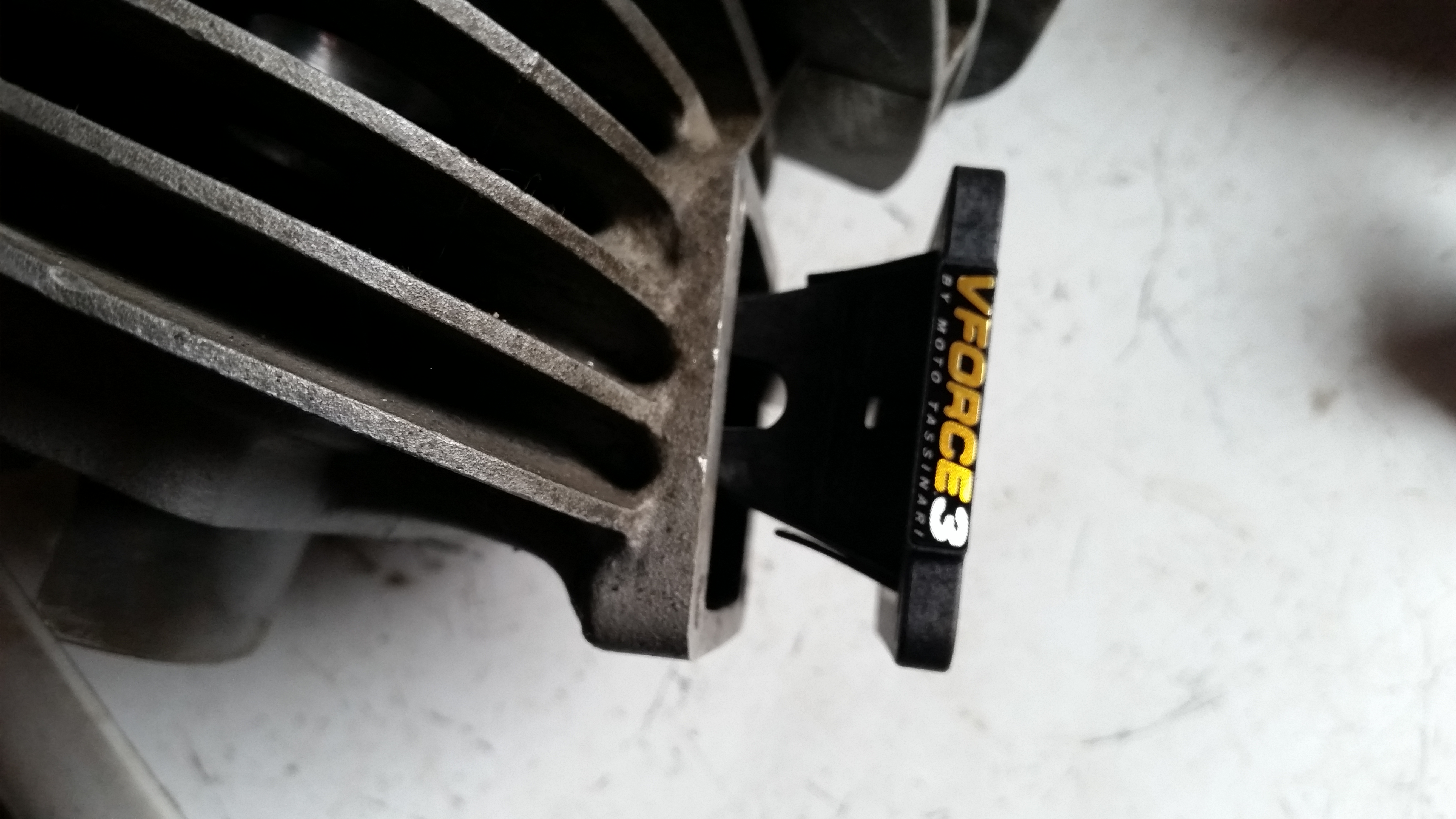

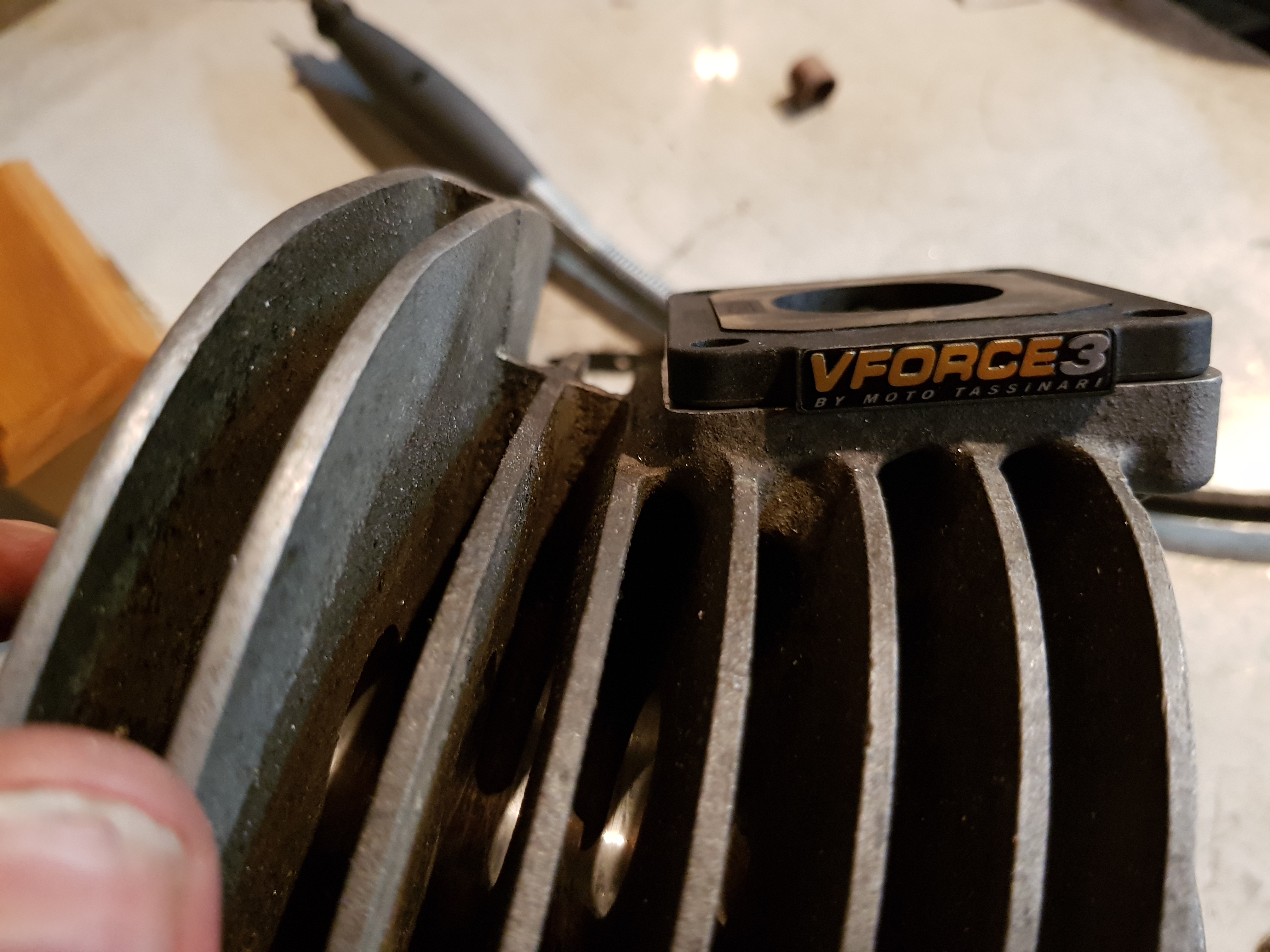

tony27 Posted October 19, 2017 Report Share Posted October 19, 2017 Finally got around to spending some quality time in the garage with a Dremel. The V-force reed is quite a bit wider than the standard TY block & only pushes in about 8mm, doing some measuring showed that at the tips the intake needs approximately 1mm per side ground out, reality is that the port has draft which is needed for casting. Quote Link to comment Share on other sites More sharing options...

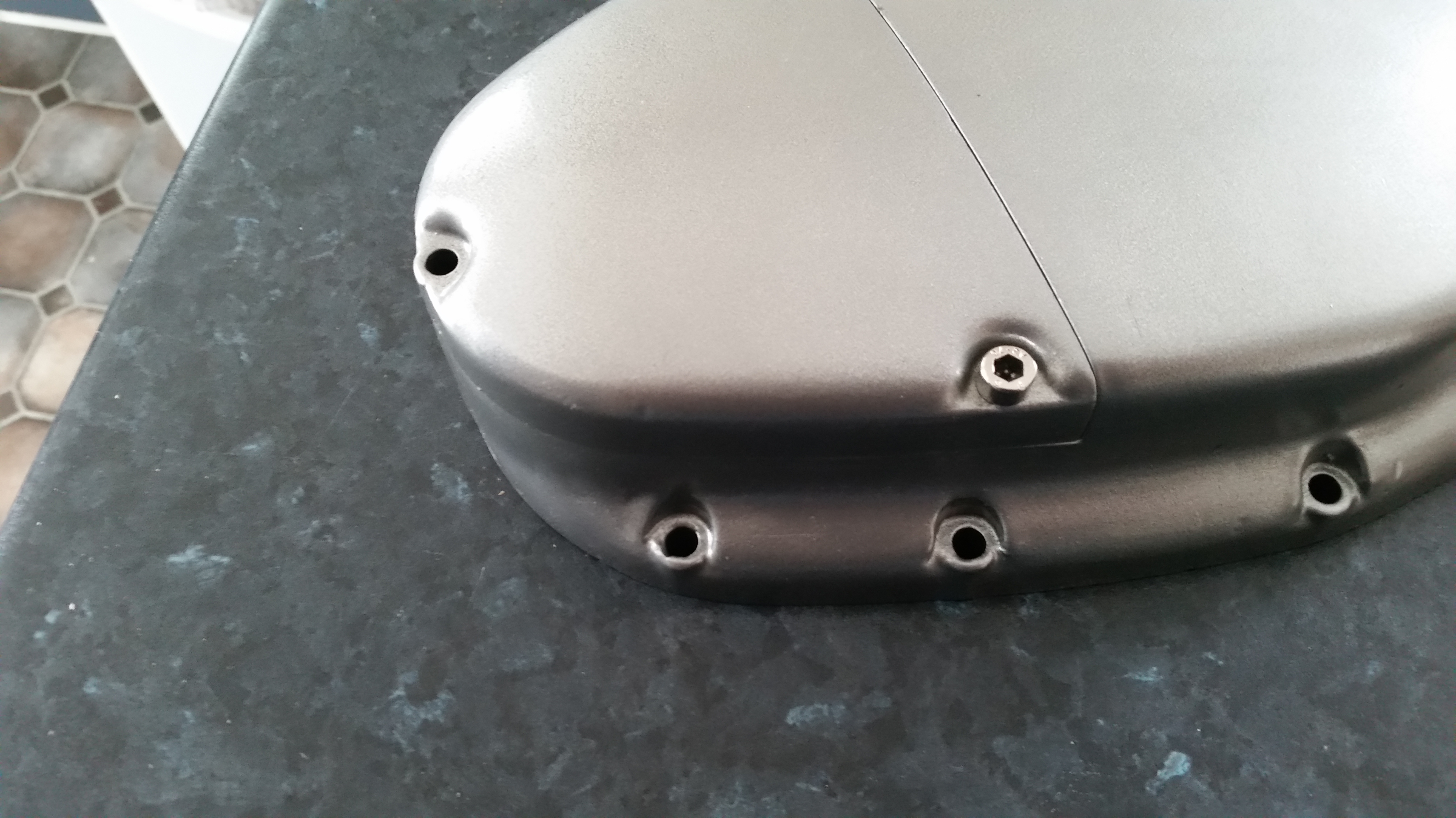

tony27 Posted October 20, 2017 Report Share Posted October 20, 2017 This is the extent of the work I did to the port to make it fit, I marked around 40mm into the port & started gently grinding there on both sides & checked often to see how far the reed would fit in. After getting the reed to slide in with the holes lining up I blended the step out to the edge of the sleeve so there is no sudden change in shape. It will be a while before I get to try the motor out as it looks like I'm going to need to get the fork sliders machined to fit a bush at the top to get rid of the play I can feel & help keep oil in them. Motor will be a lot more powerful than it was as it was so worn that I could turn it over by grabbing the end of the crank after removing the flywheel, main bearings were shot as well. I think I may have put up a couple of photos of the work I did to the clutch cover to remove all signs of the oil pump during the rebuild 2 Quote Link to comment Share on other sites More sharing options...
