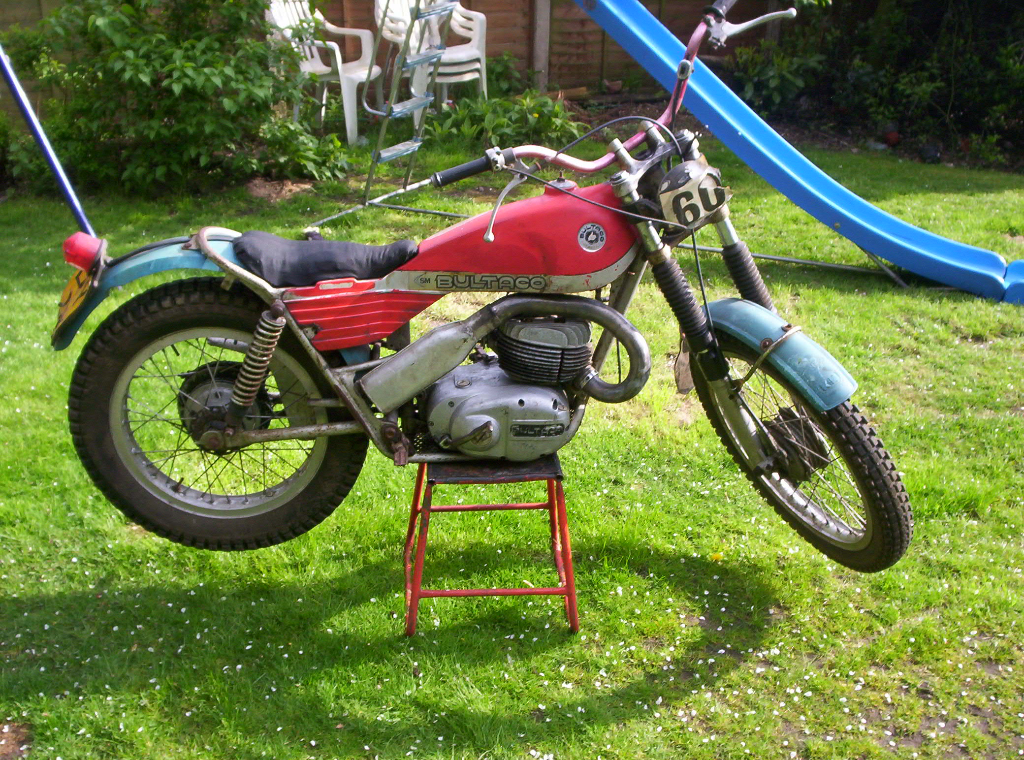

old trials fanatic Posted July 25, 2011 Report Share Posted July 25, 2011 Just aquired a model 80 which i confess i dont know much about but it's clean enough so any piccys of what one should look like? In my ignorance i assumed it would have a slimline tank and seat but err it hasnt. On a totally different subject you all know what i'm like and if i decide to use it, doubtful but still possible, what mods should i do? Dont really fancy choping the frame but just wondered if anybody had any ideas that arent irreversable? Quote Link to comment Share on other sites More sharing options...
woody Posted July 25, 2011 Report Share Posted July 25, 2011 Yes it should have a slimline tank/seat unit, picture below of my old M80 that I never got time to rebuild (wonder where it is now) As far as mods, there isn't much you can do to it really unless you want to start altering it. They are what they are, never going to be a Fantic beater. Motors are good, torquey and pull well with plenty of revs. Chassis is typical old Bultaco, back end feels dead (but works) even with good shocks. Front end a bit soft, steering is a bit slow, they feel long but will turn tight, but if you get off line with them they aren't like an Ossa which you can just get straight back on line with a flick of the bars, they need a bit more room. Clutch is not as easy to adjust finitely as the springs are held by pins, unlike the later bikes which have nuts which allow the tension to be altered. However, they'll ride down to nothing (with no tickover) without the clutch having to be used. Best you can do is just get everything working as it should, motor, brakes, clutch, suspension. There's not much point getting into heavy mods like steering, shock position, as you may as well just ride a later model. Just enjoy it for what it is - but it will be a bit of a culture shock after the Ossa... Quote Link to comment Share on other sites More sharing options...

woody Posted July 27, 2011 Report Share Posted July 27, 2011 Hey Paul, I was trying to keep it cheap for you.... I can give you lots of 'budget-busting' ideas... The M150 like Javier's is quite a bit different from the M80 and they are a tighter, more nimble feeling bike. The engine case, forks, swingarm are all standard for that model. Exhuast middle box is not standard - looks like a Miller ? Back box is standard for that model. It is a pity we don't have the Pre72, Pre77 etc classes in the UK but I can just imagine the can of worms if we tried. The M80 is good for Midland Classic events though as they are only supposed to run Pre72 I think. Quote Link to comment Share on other sites More sharing options...

old trials fanatic Posted July 27, 2011 Author Report Share Posted July 27, 2011 On 7/27/2011 at 1:11 PM, Woody said: Hey Paul, I was trying to keep it cheap for you.... I can give you lots of 'budget-busting' ideas... The M150 like Javier's is quite a bit different from the M80 and they are a tighter, more nimble feeling bike. The engine case, forks, swingarm are all standard for that model. Exhuast middle box is not standard - looks like a Miller ? Back box is standard for that model. It is a pity we don't have the Pre72, Pre77 etc classes in the UK but I can just imagine the can of worms if we tried. The M80 is good for Midland Classic events though as they are only supposed to run Pre72 I think. OOOPS!! sorry just showing my ignorance of Bultaco models. Was toying with the idea of changeing the forks yokes for later ones as i have a good set of early MAR fork legs in the garage and i believe the tubes fit the Bultaco Betor sliders. Dont like the taper forks or their yokes plus they need rechroming and i do have good non taper ones anyway. Do feel like doing something with the footrests as they just dont feel right. Also the wheels do look a bit heavy so as later ones are fairly freely available might be worth it? As for Midland Classic events they arent in the picture for me i'm afraid as due to "political" reasons i'm not really welcome there. Just Dales and Peak Classic where all twinshocks and me are welcome Just took the bike in as a swap and always fancied one since my first one all those years ago. As i said earlier though just really fancy replacing the Homerlite tank and seat with a proper slimline one but what with the current fibreglass problems it's not looking promising. Suppose my problem is underneath it all i think i like fiddle bikes but they have to at least not look like one if you know what i mean ? Quote Link to comment Share on other sites More sharing options...
