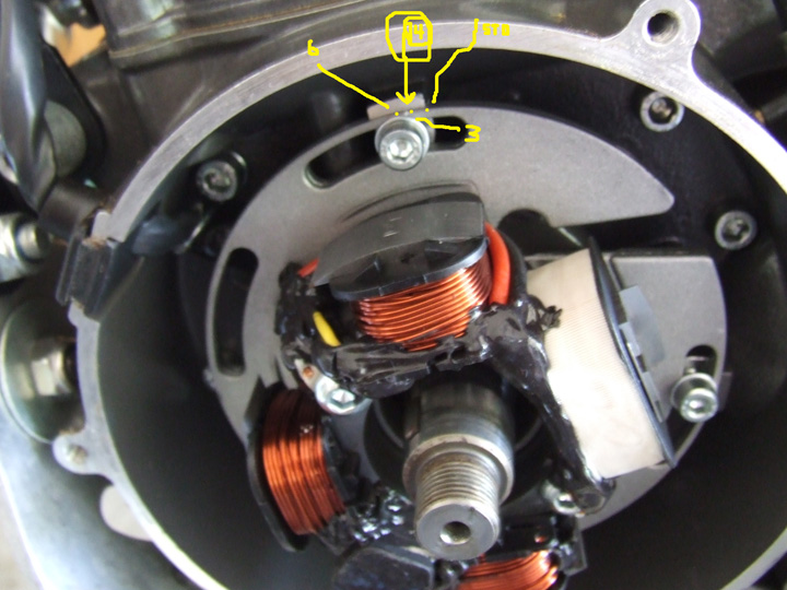

hop blip and a jump Posted August 4, 2011 Report Share Posted August 4, 2011 Anyone got any advice on where to set the stator plate for the best starting running?? advancing / retarding the ignition?? pics please? Quote Link to comment Share on other sites More sharing options...
copemech Posted August 5, 2011 Report Share Posted August 5, 2011 (edited) Anyone got any advice on where to set the stator plate for the best starting running?? advancing / retarding the ignition?? pics please? This should work, set back 3-4mm from std. Std tic mark on stator aligns with right edge of casting, Edited August 5, 2011 by copemech Quote Link to comment Share on other sites More sharing options...
