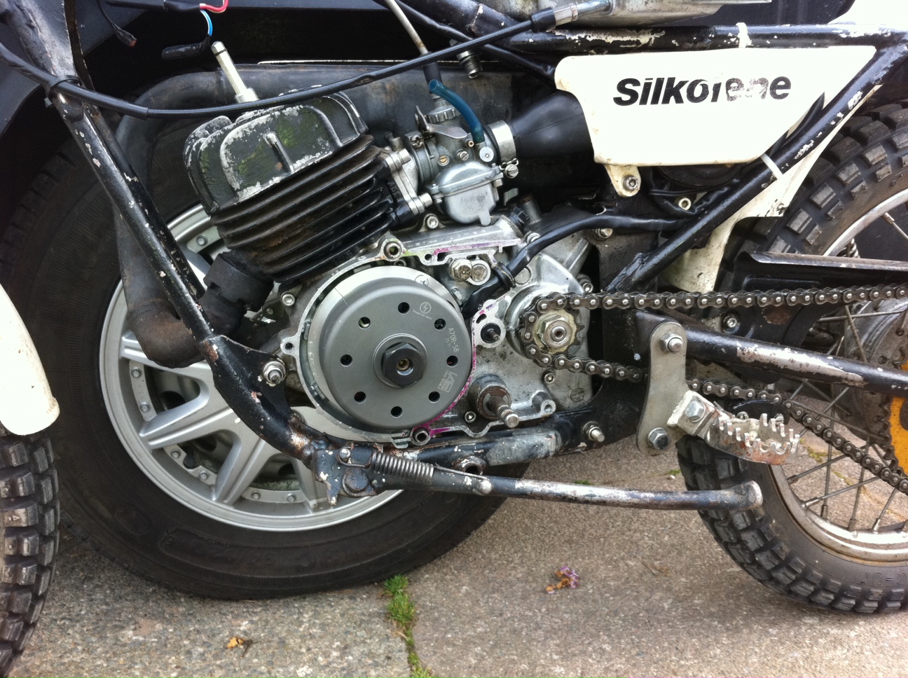

I just purchased a new electronic ignition system from Powerdynamo.biz :thumbup: it has just been made available on the market and I purchased the first one they made. It comes with everything from the stator plate to the fly wheel in the kit.
I fitted it in around 30 mins, you need to have a TDC tool and a gear puller (the original puller is different), but apart from that it really was VERY simple to fit. You can have it with or without the lighting kit for around
