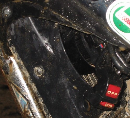

wobbly1 Posted April 2, 2005 Report Share Posted April 2, 2005 I took this photograph at the Red Rose round of the British Championship in October 2004. The thermostat has a bypass switch which allows the fan to be switched on if the thermostat fails. Unfortunately I can't tell you who's bike it was or what year. Quote Link to comment Share on other sites More sharing options...
trials lad Posted April 2, 2005 Report Share Posted April 2, 2005 huummm not a bad idea that. Quote Link to comment Share on other sites More sharing options...

motomax Posted April 4, 2005 Report Share Posted April 4, 2005 I replaced my 04 Raga thermostat the other day. It was straight forward. Uses a little circlip to hold it in. The biggest problem is getting the radiator out and in, its a tight fit! I tried fitting an 04 Std Pro thermostat in line but it did not work! Not sure why? It works in my 04 Pro but not my Raga bike? Figure that? I like the switch idea, I think I will do the same. The symtoms were overheating with coolant running out of the overflow, no fan. I tested the fan, rectifier and both were ok. Replaced thermostat and problem solved. Quote Link to comment Share on other sites More sharing options...
