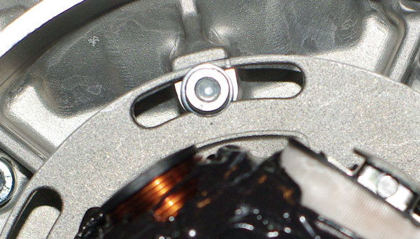

myzeneye Posted October 11, 2011 Author Report Share Posted October 11, 2011 Quote Thout you stated it was initially set full back at the limits of the screw slot? no, sorry dude, it was origianlly set as follows : the chiselled mark on the stator lined up with the extreme right hand, outside edge of the square'ish block which the allen bolt srews into. the elongated slots are positioned more so to the right hand of the slot, as thought the stator has been rotated anti clockwise ( i beleive to retard)theire is still a little travell on the slots to go if i wanted to keep turning the stator anti clock wise but only mayebe around 5mm or so... what im thinking is..... i cant really make out the three timing marks which im told should be stamped into the crank case ( on the squarish block im talkin bout...) there are no real visible marks.... the slot in my stator is set to the extreme outside edge of this block, not a mm or two inside the edge, or in the middle or a mm or two from the right hand edge..... i know that probably sound like gobble de gook, its hard to explain.... when i look at marks stamped in case on photos in other threads like this, the marks are NOT on the extreme out side edge..(in effect, im using no mark,im setting the mark on the stator to the edge of this block where it would be physically impossible to leave or stamp a mark......) thats what tells me this is not right ! added to that, the bike runs double wicked hot. any one with a picture or diagram of an 03 (or there abouts ) bike, please please please, post a pic for me.... im chuffed that ive managed to do this job myslef, but i dont want to throw good money away and fry another stator. (as well as cook all the chrome finish off me exhaust (which incidentally was like brand spanking new, untill i run an irriduam plug and my bike satrted running hot and ending up like this....co-incident....maybe....???) thanks cope, im nearly there on this one... :thumbup: Quote Link to comment Share on other sites More sharing options...

splatshop Posted October 11, 2011 Report Share Posted October 11, 2011 On 10/11/2011 at 8:28 AM, myzeneye said: what im thinking is..... i cant really make out the three timing marks which im told should be stamped into the crank case ( on the squarish block im talkin bout...) there are no real visible marks.... the slot in my stator is set to the extreme outside edge of this block, not a mm or two inside the edge, or in the middle or a mm or two from the right hand edge..... These marks on the crankcase were only on the older bikes before the Leonelli ignitions. The marked stamp should be to the right hand side of the top securing bolt. The mark should line up with the right of the casting lug holding the stator in place. Hope this helps. Quote Link to comment Share on other sites More sharing options...
myzeneye Posted October 11, 2011 Author Report Share Posted October 11, 2011 (edited) On 10/11/2011 at 9:58 AM, splatshop said: Hi Matt, I am sorry that the reconditioned exchange stator isn't what you expected, if you would like you can send it back to us and wait 3 weeks until your stator arrives back from Steve Hardraker we can do that, not a problem. We offer the exchange service for people that want to get back on their bikes as soon as possible, when a stator is repaired the majority of the time it is just the hall sensor that is replaced. When we receive a stator that has been damaged (i.e. coils, backplate) then other parts will be replaced. We will always recommend to our customers to have a reconditioned stator over a new stator as Steve replaces the hall sensor with one that is better quality the original, so there is less chance of you having problems in the future, while saving you money. Please see the attached photo, so you can see where the notch on the stator should be lined up against for factory standard timing (please note this is a photo of a later bike, but the same position applies). Regards Tim Pearson SplatShop.co.uk thanks tim, i appreciate your response...and to be fair, i had'nt mentioned where i had bought the stator from, purposefully, as i am usually more then happy with the service i get from splat. i guess i was just expecting a proper "recon" type part, not second hand, bit raggard round the edges repiared job.....trust me, i want to get straight back out on my bike but i also want value for my money...at only 40 quid less then a new stator, that hall sensor must cost a fair few quid... however, you convinced me over the phone that the uprated hall sensor is what matters, so i took your expert advise and kept the stator. sorry, im just a fussy bugger. as for the picture, thanks for posting it... yes, thats where ive set it to... is that factory/ tdc in that position ? i ran the bike briefly to see it run and fire up etc... it ran for around 45 seconds (as it was a bit late at night.... ) in this short short time, the exhast was quite hot already...... from the marks on that picture...would full anti clock wise rotation of that stator, so it was at the end of the elongated parts, be fully retarded or are we only talking incremants of mm's ....? Edited October 11, 2011 by myzeneye Quote Link to comment Share on other sites More sharing options...
splatshop Posted October 11, 2011 Report Share Posted October 11, 2011 On 10/11/2011 at 11:19 AM, myzeneye said: from the marks on that picture...would full anti clock wise rotation of that stator, so it was at the end of the elongated parts, be fully retarded or are we only talking incremants of mm's ....? Yea, fully anti-clockwise would be very retarded, but I would only recommend moving it up to 5mm. If you go to retarded you may find that the fuel isn't fully burnt before the exhaust port opens, which could possibly make your exhaust very hot. If you go to advanced then the fuel will ignite too early which will put a lot of strain on the piston and cause a lot of heat, you will notice the bike tends to backfire/kickback when starting. How long is it taking for the fan to kick in once the bike is running on tickover? Quote Link to comment Share on other sites More sharing options...
myzeneye Posted October 11, 2011 Author Report Share Posted October 11, 2011 On 10/11/2011 at 11:56 AM, splatshop said: Yea, fully anti-clockwise would be very retarded, but I would only recommend moving it up to 5mm. If you go to retarded you may find that the fuel isn't fully burnt before the exhaust port opens, which could possibly make your exhaust very hot. If you go to advanced then the fuel will ignite too early which will put a lot of strain on the piston and cause a lot of heat, you will notice the bike tends to backfire/kickback when starting. How long is it taking for the fan to kick in once the bike is running on tickover? ill investigate tonight tim.... ive got the timing set with the stators mark as you say, lining up with the right hand side of the casting lug holding the stator in place. if this is factory setting or, tdc, then that should give me no real problems with unburts fuel should it ?....what i dont understand is, if the mark on the stator lines up with that outside edge of the casting lug, how can there be any kind of mark to line up for retarding position.... or is it just a case of moving the mark a few mm beyond the edge of the lug??? jeez, theres no exact science here... i dont have a strobe and would know how to use one if i did..hahha but i just want to be sure im not gonna damage the bike before i go for a ripp on it.......... ill report back with fan time details later... thanks again... Quote Link to comment Share on other sites More sharing options...

copemech Posted October 11, 2011 Report Share Posted October 11, 2011 (edited) On 10/11/2011 at 5:30 PM, myzeneye said: ill investigate tonight tim.... ive got the timing set with the stators mark as you say, lining up with the right hand side of the casting lug holding the stator in place. if this is factory setting or, tdc, then that should give me no real problems with unburts fuel should it ?....what i dont understand is, if the mark on the stator lines up with that outside edge of the casting lug, how can there be any kind of mark to line up for retarding position.... or is it just a case of moving the mark a few mm beyond the edge of the lug??? jeez, theres no exact science here... i dont have a strobe and would know how to use one if i did..hahha but i just want to be sure im not gonna damage the bike before i go for a ripp on it.......... ill report back with fan time details later... thanks again... Timing should be fine in the original position set along the right edge. If you did decide to retard it a bit you turn the plate counter so the mark on the stator plate is well inside the casting web. No real need to mark it, just measure the distance. The exact numbers here, either in degrees or mm BTDC are not important, as you just need them in the proper range for proper operation. If it is kicking back or stalling too easily, kick it back just a tad bit. If it is just too aggressive in the power for you, go a tad more. All to taste! As Tim stated, a -5/6 mm would be maximum reccomended retard, with -3/4 being mid, and -1/2 being minimal change. Edited October 12, 2011 by copemech Quote Link to comment Share on other sites More sharing options...
