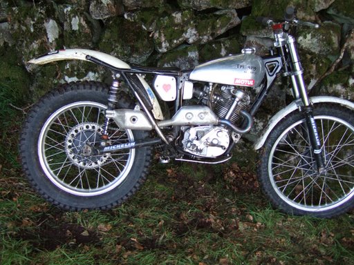

toofasttim Posted October 26, 2011 Report Share Posted October 26, 2011 And this is an extreme example: Quote Link to comment Share on other sites More sharing options...

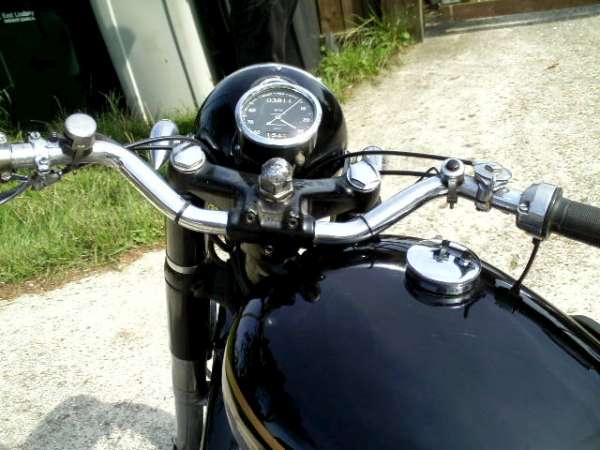

brownee Posted October 26, 2011 Report Share Posted October 26, 2011 Not read this thread in full but just posting this on behalf of my Dad who wanted to show how it can be done.... Quote Link to comment Share on other sites More sharing options...
brownee Posted October 26, 2011 Report Share Posted October 26, 2011 Or should I say "Should be done" Quote Link to comment Share on other sites More sharing options...
feetupfun Posted October 26, 2011 Report Share Posted October 26, 2011 Or should I say "Should be done" It would be helpful to be able to see the triple clamps Quote Link to comment Share on other sites More sharing options...
