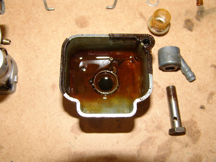

I the gum isn't too old, (some kind of slimy), a carb cleaner will do the job, even normal gas and diesel oil. When it got gelantinous a carb cleaner may get it dissolved may be not. Then you can give the carb to your next shop where they have a ultra soni cleaner. If the gum got "crusty", (couple of years and some other weirdo debris show up too then this can bee a real issue), looking like this:
