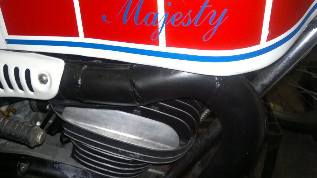

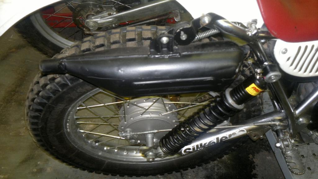

wobbler Posted August 3, 2012 Report Share Posted August 3, 2012 (edited) Gents, Interesting to read "Samyam's" comments - I've attached a couple of shots of the exhaust on Godden Majesty which seems to have had the exhaust altered and a back box like i have never seen before - as far as i'm aware this has all been from new Edited August 3, 2012 by wobbler Quote Link to comment Share on other sites More sharing options...
johnnyboxer Posted August 3, 2012 Report Share Posted August 3, 2012 That's a standard TY125 back Silencer Doubt it was on from new, however Shirt did convert a lot of 125's into Mini Majesty's, so I could have Heavier and probably more restrictive than a Ty175/250 standard silencer Fit a WES Quote Link to comment Share on other sites More sharing options...
