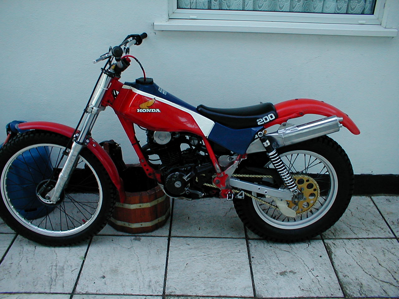

james111089 Posted April 9, 2005 Author Report Share Posted April 9, 2005 Heres a pic of the tlr see what you think I have now sorted the headstock bearings they just wernt tightend up. James Quote Link to comment Share on other sites More sharing options...
booma Posted April 10, 2005 Report Share Posted April 10, 2005 looks tidy James, plus the wheel rims have been changed so they won't have the dreaded rot are you going to modify it in any way or just ride it as it is Quote Link to comment Share on other sites More sharing options...
james111089 Posted April 10, 2005 Author Report Share Posted April 10, 2005 I have ordered a new set of brake pads and fork seals. I may think about saving up for a tank seat unit. The paint work on the engine is a bit tatty you cant see it all in the pic but i might respray it in the winter. I am going to take the swinging arm out soon and give that a fresh coat of paint. The wes pipe polishes up nice but has one small repair done on the back where the wheel has rubbed through at some point not to bad. If there any noises to look out for on the motor? Just out of intrest. it also has recently just had a new slide in the carb and jets etc. James Quote Link to comment Share on other sites More sharing options...

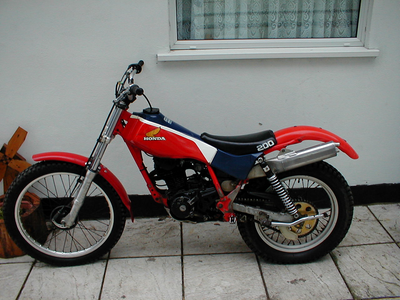

james111089 Posted May 2, 2005 Author Report Share Posted May 2, 2005 Looking a bit tider now................. James Quote Link to comment Share on other sites More sharing options...
